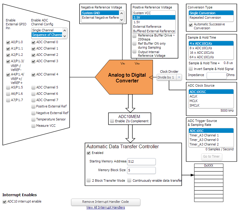

  • Alas, this had no effect .  I built a new program with grace for the config and kept my main loop, editing vector interruption for CPUOFF.
    Yes, ADC10OSC clock is tied to ADC10 and should be working in LPM0 (CPUOFF).
    But setting MSC will repeat conversions without trigger from AC10SC.
    I want to start conversions on demand.

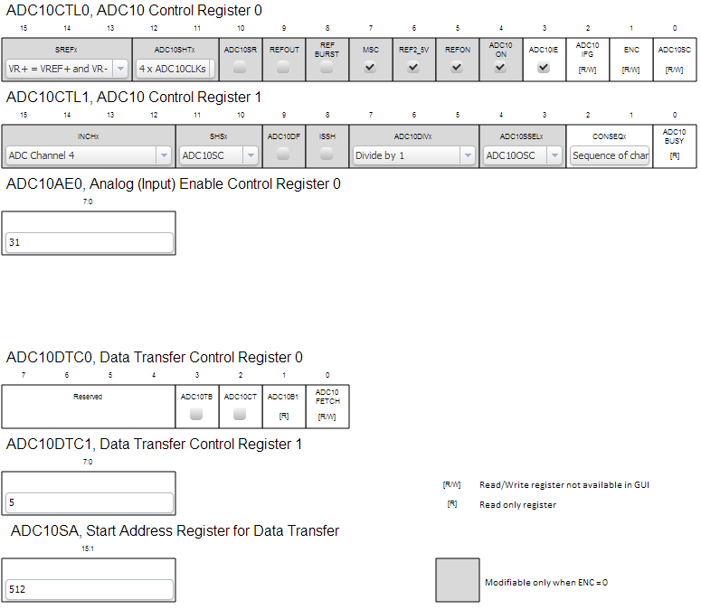

  • Ok, I want behaviour 1, you are fully right. I turned on MSC with Grace and.... the counter started!
    But it stopped after 7 iterations ( i==7 ). Strange...
    I went to the registers and I found ADC10SC was not set.
    So I remembered a post about a double ADC10SC command as recommended by
    https://e2e.ti.com/support/microcontrollers/msp430/f/166/t/263756?tisearch=e2e-quicksearch&keymatch=msp430%20%20ADC10%20no%20interrupt
    Now my counter is working almost fine, but it is weird. I'm not sure of the stability.
    When I came back to my first version, it got stuck after some 50k samples when I paused the execution to see the counter.
    I was also obliged to repeat twice the initialisation of the ADC10SA during the initialisation of the ADC to get the loop working. See below.

    I noticed this happens with the Grace version when I try to slow and use divider ADC10DIV >1 with ADC10OSC. Maybe the problem comes from the clock speed, or from the debugging?... Anyway, I have enough samples to do my calibration.
