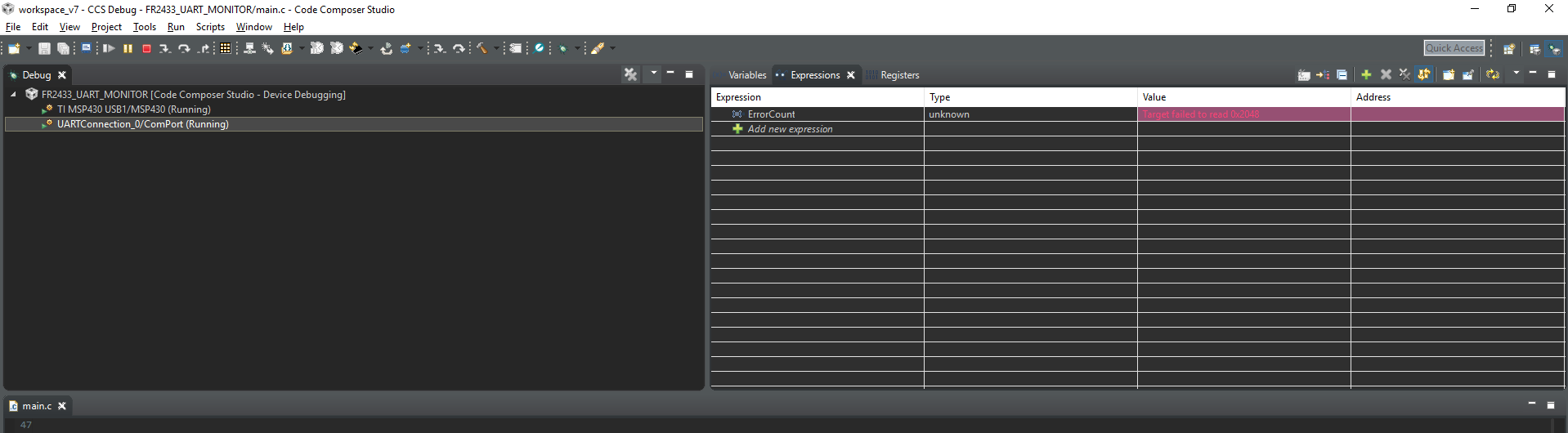

I try to use the ProgramModelUart method to debug some expressions in the debug window while running some simple code on the FR2433 LP.
Always using a refresh intervall of >=500ms but the results are unstable. Are there any known problems with this type of communication?
I attached the src and two pictures.

  • Hi Ben,
    MSP430 not support real time debug so with continuous refresh function it will halt the CPU then read out the value from ram and it seems have some problem some time, a workaround could be:
    1. add a break point in your code line 133 which close to the expression ErrorCount.
    2. in break point properties, set Action as UpdateView.
    Could you try that and see if it works for you?

  • Hi Xu,
    Sorry but I do not think you are right. The main goal should be to have a refresh function without halt the CPU - thas why it is using UART and the pointer structure. I had this thing running on a MSPG2553 LP earlier on. This was with a older Version of CCS on a WIN7 machine.
    Ben.

  • The app was not running on GUI v2 - it was running on GUI v1. There also might be a way to run GUI v1 on CCS 8 or CCS 7.
    It was quite a while ago I was running this example but I am pretty sure that this was a continious process, without halting the processor. And this is in my opinion what the Serial_Cmd_Monitor files are used for.
    For example, if I create a LabView program and implement the protocol there, then I can retrieve virtually any variable via the addresses of the variables from the .map file - but unfortunately this is no longer possible via CCS.
