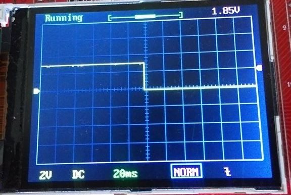

    I checked it with oscilloscope, SCL is being kept low right after starting of debugging, without even one signal.
    toann
    To clarify, you never see the SCL line go high? I'm a little confused here, because in your code you include a comment that indicates that it is getting stuck in the USCI_B ISR? Is this true? Because, if the SCL line stays low, then there shouldn't be anything to cause the device enter the ISR, so I am not sure how this would have happened.
    Nathan

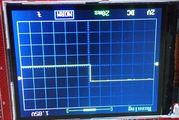

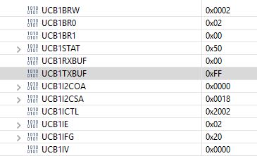

  • I changed B0 to B1, nothing differs. Here's how SDA looks like:

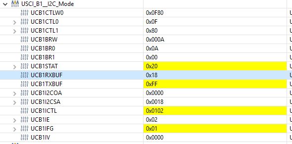

    SCL looks the same. And here are registers:
  • Where is your program executing (stuck?) after the change? Also: In what order are you calling these functions?
    The DS2482 doesn't (can't, per data sheet p. 21) do clock-stretching, so the USCI must be doing it. Clock-stretching is consistent with not servicing RXBUF (or TXBUF as appropriate). Reading UCB1IV clears RXIFG, but the F5 User Guide (SLAU208O) section 38.3.4.2.2 talks about reading the RXBUF, not clearing the RXIFG.
    Can you post your updated ISR?
  • It still hangs at "__bic_SR_register_on_exit(LPM0_bits);", just like it was before.

  • Actually that's a clue. It means that the RXIFG happened before main set STP.
    With BR0=2, you're running the I2C at 512kHz, which is faster than Fast Mode. More to the point, the CPU has only 2*8=16 clocks after STT goes low to set STP [Ref F5 User Guide SLAU208O Figure 38-13]. That's maybe 3 instructions, which isn't much.
    Once the first byte comes in, you won't be able to get out of the ISR before the next byte arrives (16 more clocks) so you'll never get back to main.
    Try setting BR0=10 (100kHz) and see if your program acts different.
  • It didn't act different, still stucks at the same place.
  • I think the debugger's claim that you're sitting in the RXIFG case (with RXIE=0) is just false. I'm pretty sure it's related to Erratum UCSI39 [See also F5529 Errata Sheet SLAZ314W]. The workaround is to set GIE early in the program. Add this just after the initI2C() call:
    > __enable_interrupt();
    The reason you're stalling is that you're requesting a Start (in startCommand()) before you've set up the Tx parameters, so the transmission (length 0) ends immediately and "wakes" main long before it goes to LPM0. By the time the LPM starts, there's no event left to wake it up. Move the STT setting into sendData, after you've set up PTxData and such.
    Unsolicited: sizeof(unsigned char *) is the length of the pointer, not the data. Change sendData to pass an explicit length.
  • Okay, still doesn't work but finally something happened: now it stucks there:

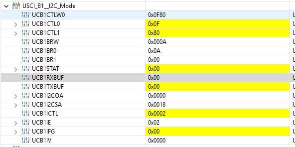

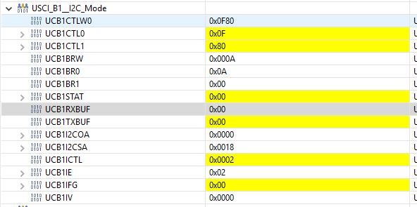

    After initI2C() registers are:

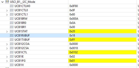

    When it stucks, registers are:
    RXBUF changes to 0x18 after: " UCB1CTL1 |= UCTXSTT;        // send restart" in restart(int type).
  • You need to enable the RXIFG that's pending, something like:
    > UCB1IE |= UCRXIE0; // Enable RXIFG
  • The first time I run it after adding "UCB1IE |= UCRXIE; // Enable RXIFG" it worked but then I restarted program and now it stops at "__bis_SR_register(LPM0_bits + GIE);" in sendData(). At the moment it stucks, only TXIFG is 1, others IFGs are 0.
  • That's odd. Did UCTXIE0 get turned off somewhere? (I don't see it in what you've posted.)
  • Not intentionally, for sure. Here's current code:
