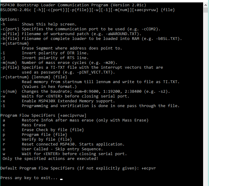

    Sergei, if you can buy a generic USB-to-serial module locally, I believe you can use it to flash.  Such a module would be an FT232, a CP2102 or a CH340, and you would have to download and install the correct driver for the module.  Just make sure it is a 3.3V module, not 5V.  Then I  think my version of BSLDEMO would work with the module.
  • Thank you, George!
    The module that I have is built on a chip CH340T. Installed drivers, checked for 3.3 v.I already downloaded your version of BSLDEMO, thank you very much! But I did not fully understand how it works. Where can I find this information? Can I read data from the microcontroller without knowing the password? Can I count on your help with my project? If I have any questions, how can I contact you?
  • Sergei Huiva said:
    Thank you, George!
    Sergei, I participate here as I have time, but you will need to get the TI support people to help you get things working.  SLAU319 has most of the information about BSL (see Table 19), but I don't think I've ever seen a PDF devoted to BSLDEMO.  If you run BSLDEMO with the -h option, it will show you all of the command line options.  You have to specify the COM port your CH340T occupies, but other options depend on what you want to do.  You do have to know the password to read data.  You will have to make sure the CH430T pins DTR, RTS, TxD and RxD are connected to the appropriate pins of the F449,, and I believe you will need to use both the -i and -j options in my version of BSLDEMO. Your F449 has BSL v1.6, and I don't know what happens if you provide the wrong password.  That may cause the chip to be erased, so you must be very careful.

  • Sergei, BSLDEMO is a Windows console (command line) program. Usage is shown on the second line of your quote above.
    Put your password file and your new firmware file in the same folder with BSLDEMO, then Start/Run/CMD and navigate to that folder (may get to the command prompt differently on Windows 10).  If you have the CH driver installed on COM9, for example, then you would connect everything, and type something like this on the command line:
    BSLDEMO-2.01c.exe -cCOM9 -i -j -pPASSWORD.TXT -1 +ecpv FIRMWARE.TXT
    Both TXT files are in Ti-TXT format.  I'm guessing at  the i/j options, but some combination of those two should work.
    The connections from the CH to the chip would be DTR to /Reset, RTS to TCK, Tx to Rx (P1.1), Rx to Tx (P1.0), and of course ground to ground.  You may also need to connect the CH 3.3V output to the F449 VCC pin if the F449 doesn't have it's own power.

    Yes, I think the topic is revealed. But I'm interested in another question: as far as I understand the parameters -i and -j inverted signals DTR and RST, knowing the correct direction of these signals, can I invert them using hardware? Let's set the logical element NOT.

    Sergei, my purpose in adding the -i amd -j options was to avoid the need for hardware inverters, but still allow polarity to be changed.  But you certainly can use hardware inverters instead, and that would allow you to go back to the official TI version of BSLDEMO.  The -i and -j options apply to the DTR and RTS (not RST) outputs of your USB-to-serial adapter.  Those are the lines BSLDEMO uses to initiate a BSL session, as described in SLAU319.
