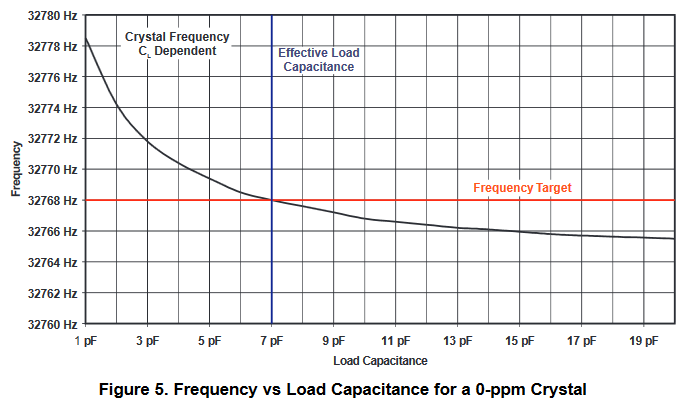

            mcu msp430f417,Crystal oscillator does not vibrate,Crystal parameters:32768hz Cl 12.5pF,
1.Configure internal 10P capacitors to work properly.
2.Configure the internal 1P capacitor, externally connect 2 22P capacitors, it can't work normally.  LFOF=1,why?
If we choose method 1, is it OK?
    Are you setting XTS_FLL=0 in your code? I would recommend using external load capacitors for the crystal for higher precision, since the internal load capacitors may vary slightly between devices. I'm assuming when you use both internal and external load capacitors, you're effective load capacitance may not be correct.
    Please read through the MSP430 32kHz Crystal Oscillators app note, specifically Section 2.1 Effective Load Capacitance.

    Setting XTS_FLL= 0 is good for LF operation with a watch crystal. Looking at page 304 in the MSP430x4xx User's Guide, setting FLL_CTL0 = 0 may cause an issue, since XT2OF doesn't exist for MSP430x41x devices and bits 3 through 0 of FLL_CTL0 are read-only. Try using the bit-wise OR operand (|=)rather than just the equal sign (=). For example, try  FLL_CTL0|=XCAP14PF;
    If you're seeing LFOF = 1, then there's definitely an oscillator fault. If your crystal's load capacitance is 12.5pF, then according to the effective load capacitance equation (Equation 3) in SLAA322, you'll need two 23pF capacitors (assuming your PCB has approximately 2nF parasitic capacitance). You're using two 22pF capacitors, which should be close enough unless your PCB has higher parasitic capacitance. I'm still not sure why you're seeing an oscillator fault flag, LFOF = 1.
    In SLAA322, you can see how the frequency of the crystal depends on the effective load capacitance.
    For your case, if XCAP10PF works, then I'd just use that until you can dig more deeply into the issue and follow all the recommendations in SLAA322. Unfortunately, this device is quite old. Have you considered using our newer FRAM devices, such as the MSP430FR4133? The FR4xx devices don't seem to have integrated load capacitors though but may have other advantages over the older F4xx devices for your application.
