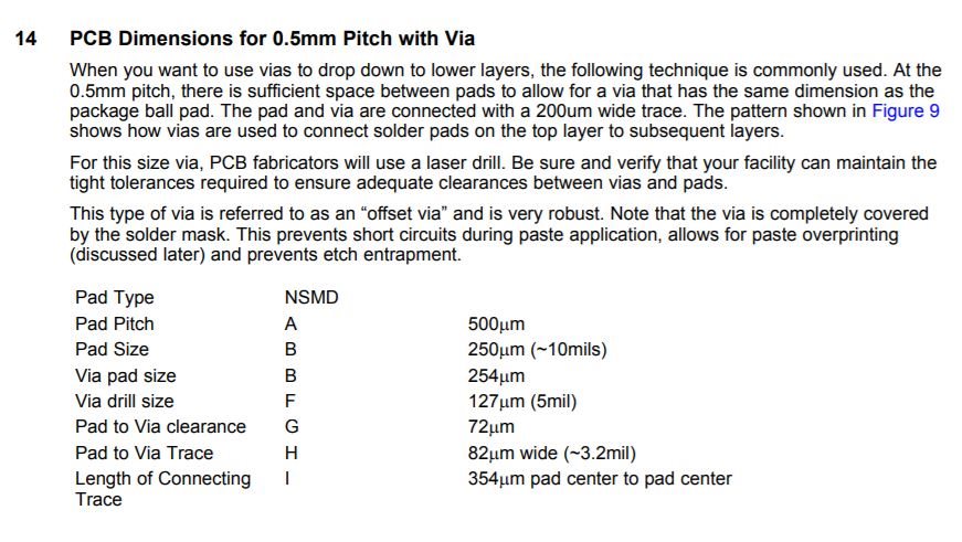

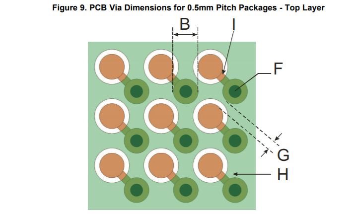

For some reason, one of our key customer has to use BGA package (MSP432P401RIZXH).
Because the ball pitch is small to them, do we have any layout design guideline or example for them?
For example, it's hard for them to use VIA in pins.
Do you have any suggestion?
