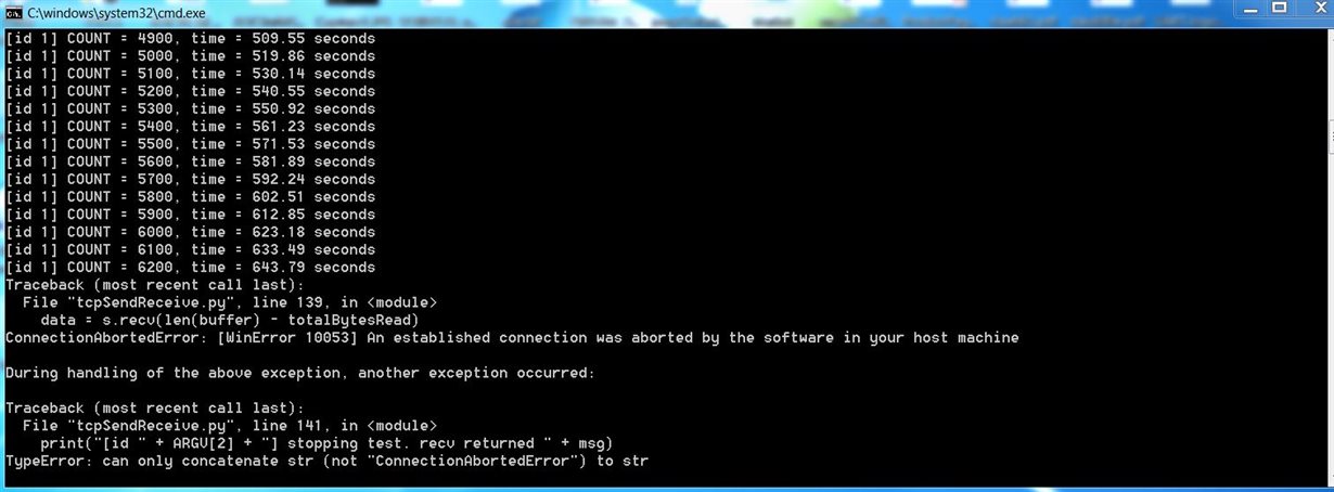

  • Can you confirm which program that you are running?  I have the PC connected to the virtual com port through the xds110 of the launchpad and the ethernet connected to a switch.   I can see the service status in Tera Term and the eco in the command line (python script).
    After a while I do get this error:
    Chris

    When connecting RJ45 directly to PC can you still see the network added?
    Are the following conditions met:
    The device must be connected to a network with a DHCP server to run this example successfully.
    The example starts the network stack. When the stack receives an IP address from the DHCP server, the IP address is written to the console.
    Run the tcpSendReceive python script that is shipped with your SDK.
    dev.ti.com/.../
    When the echo stops are any errors provided?
