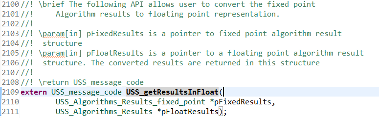

    You can use this API 'USS_getResultsInFloat()' to get the USS results in float. Then you can multiply and output as you want.

    Ty for the support. I am confused with the usage of 'USS_getResultsInFloat()'. It has 2 pointers. For the fixed point result should I link it to "USS_runAlgorithms(&gUssSWConfig, &algorithms_Results);"? Then I would get the results in floating point?
    Prudhvi Sagar
  • Hi Sagar,
    You can see a clear definition of this API in here.
    Cash Hao
    As i understand it converts fixed point results to floating point. Where do I get the fixed point results? Are they the results of "USS_runAlgorithms(&gUssSWConfig, &algorithms_Results);"?
    Prudhvi Sagar
  • Hi Sagar,
    It is this one 'USS_runAlgorithmsFixedPoint()'
    Cash Hao
    I am not getting consistent data compared to GUI and getting random erroneous values with the above code. So there must an issue with the way I am using USS. Can you help me approach this problem.
    Isnt USS_runAlgorithms(&gUssSWConfig, &algorithms_Results); also supposed to give results in float?
