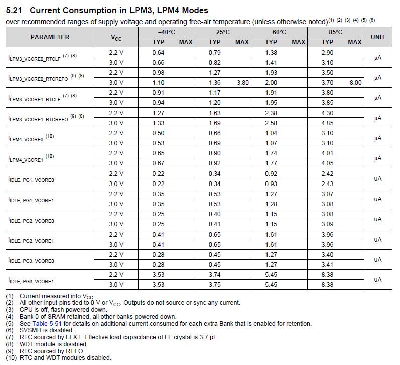

    So my question is: with the new MSP432P4x1xl devices using TI-RTOS is it possible to achieve true tick suspension (as with the CC26xx/CC13xx) or does the CPU still need to wake-up periodically (as with the MSP432P401)? If it is possible, do you mean that you can use another timer to implement the tickless mode? In that case, what would the average current consumption of MSP432P4x1xl devices as compared to the CC26xx/CC13xx series?

       The MSP432 devices use TIMERA0 for the TI-RTOS tick.  As you have pointed out, in the case of the P401 devices this clock is not available in LPM3 (deepsleep).  The tick suspension (Dynamic mode) is described here.
        The current is found in the datasheet.  Please note however, that the peripherals are divided into islands so the peripherals that are also on the same island as timerA0 will also contribute.

  • Hello Chris, thanks for your answer!
    It is now clear to me the difference in LPM3 between the "old" and the "new" MSP432 devices and how that enables TI-RTOS tickless mode.
    The only pitty is that the information is so buried down in the datasheet (page 135) that it is not easy to find while comparing both devices.
    Being such a nice feature with regard to low power operation (it can save several micro-amperes while allowing the system to wake-up with micro-second granularity) I would suggest to add it in the datasheet front-page.
