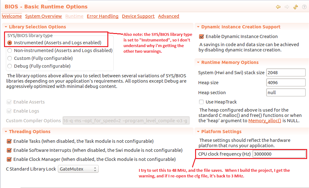

Any idea how to fix these warnings I see when I build my software packages?
  1. warning: ti.sysbios.BIOS: "/opt/ti/simplelink_msp432p4_sdk_2_10_00_14/kernel/tirtos/packages/ti/sysbios/Build.xs", line 162: ti.sysbios.BIOS assertsEnabled: Asserts are enabled when BIOS.libType is set to BIOS.LibType_Instrumented
  2. warning: ti.sysbios.BIOS: "/opt/ti/simplelink_msp432p4_sdk_2_10_00_14/kernel/tirtos/packages/ti/sysbios/Build.xs", line 172: ti.sysbios.BIOS logsEnabled: Logs are enabled when BIOS.libType is set to BIOS.LibType_Instrumented
  3. warning: ti.sysbios.BIOS: "/opt/ti/simplelink_msp432p4_sdk_2_10_00_14/kernel/tirtos/packages/ti/sysbios/BIOS.xs", line 1045: ti.sysbios.BIOS cpuFreq: PLL configuration is overwriting previously set BIOS.cpuFreq.
My xdc config file is below:

BIOS.libType = BIOS.LibType_Instrumented;

//BIOS.logsEnabled = true;
BIOS.logsEnabled = false;

BIOS.cpuFreq.lo = 48000000;

  • Hello Sai,
    I Created a new project from :
    New->Project->CCS Project
    I used "Open Resource Explorer" to import the following:
    Software->SimpleLink MSP432P4 SDK - v:2.20.00.12->Examples->Development Tools->MSP432P4111 LaunchPad->TI Drivers->empty->TI-RTOS->CCS Compiler->empty
    When I attempt to chance the clock rate in the config file, it saves, but when i compile the project, I get the PLL warning.  If I re-open after that compile, the CPU Frequency is back to 3 MHz.
  • Hello mark,
    I changed the CPU clock frequency to 48MHz and the build did not give the warnings that you reported in the first post. The ones I get are the following, which I think is just reporting and you can ignore them.
    The following are the versions I used:
    • CCS v8.0
    • SimpleLink MSP432P4 SDK v 2.10.00.14
    The following is what I did:
    • Import the empty project into CCS Desktop (using TIRex like you showed)
    • Open the "release.cfg" file of "tirtos_builds_MSP_EXP432P4111_release_ccs" with the "XCONF" editor.
    • Update the "CPU clock frequency" to  48000000 - As you have shown in the screenshot.
      • To confirm if the updated clock frequency is being built, I opened the "release.cfg" file using "text editor". the last line of that file has the following which says the updated clock frequency is used.
      • BIOS.cpuFreq.lo = 48000000;
    • Note, if I check the box against "Instrumented", like you showed, then I get similar warnings to what you have shown. Again I think they are just reporting and can be ignored. A rebuild will not show the same errors.
    Sai
