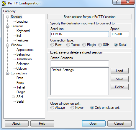

Hi, I have a problem with the "uart_echo_MSP_EXP432E401Y_nortos_ccs " example from "simplelink_msp432e4_sdk_2_20_00_20". Once I upload the code to the uC the PC is not able to stablish communication with any available port. As you can see in the image once I connect the board to the PC two new ports appear (COM 15 and 16), but a  Putty terminal is not able to read or send data to them, neither the CCSv8 terminal tool.
What can be the cause of this problem?,
Thanks.

  • Hi Sai, I do not know what did you mean by " refer the Readme", but here is how I  configured it:

  • Hello Josue,
    I just tried the example and it works for me. The following are the details.
    Hardware:
    • MSP-EXP432E401Y - with default jumper setting
    Software:
    • SimpleLink MSP432E4 SDK v2.20.0.20
      • ./examples/nortos/MSP_EXP432E401Y/driverlib/uart_echo/
    Tools:
    • CCS Desktop v8.0
    • Tera Term v4.89
      • Terminal settings used:
        • Port: XDS110 Class Application/User UART (COM53)
        • Baud: 115,200 baud
        • Data: 8 bit
        • parity: none
        • Stop: 1 bit
    Output:
    You could use Putty too as long as the terminal settings are as shown above.
    Are you doing anything different.
    Sai

  • Hi Sai, Hi Keith, I solved the issue, the problem was ( I do not know if is correct to interpretate it like this) the version of the XDS110 driver. I believe this because before installing CCSV8 I already had installed CCSV6 on my PC, so I thought that this version of CCS installed the XDS110 driver that works for the MSP432P401R launchpad which has a TMC41294 chip on it, but the MSP432E401Y launchpad has a TM4C129E on board, so I unistalled the previous version of the XDS110 and install it again from "SimpleLink MSP432E4 SDK v2.20.0.20".
