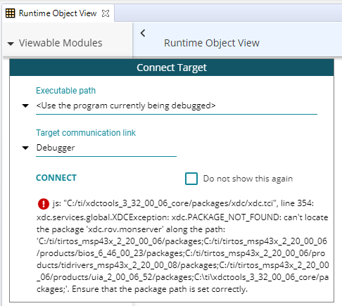

I have tried to run Runtime Object Viewer and I have obtained a failure.
xdc.rov.monserver has been introduced with XDCtools v3.50.x.xx.
Issue is that XDCtools v3.50.x.xx is not compatible with TI-TOS v2.20.0.06 for MSP430.
Did I missed something or should I try to experiment with an earlier versions of CCS, v7.4.0 for example?

    Do you have 3.50 installed also? Runtime Object View should be pulling that one in behind the curtain. Don't use 3.50 with your application though. TI-RTOS 2.20 needs XDCtools 3.32.xx.

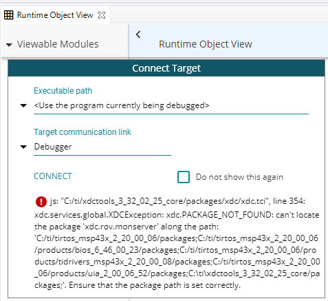

    I did as follows:
    1. uninstalled all 3.50.x.x using   Window -> Preferences -> CCS -> Products
    Reference to the xdc.rov.monserver exists.
    2. deleted all dirs containing 3.50.x.x XDCtools
    As above.
    3. uninstalled all 3.32.x.x, deleted them from HDD and installed 3.32.00.06
    The same.
    4. Switched from CCS 8.1.4 to 7.4.0
    The same.

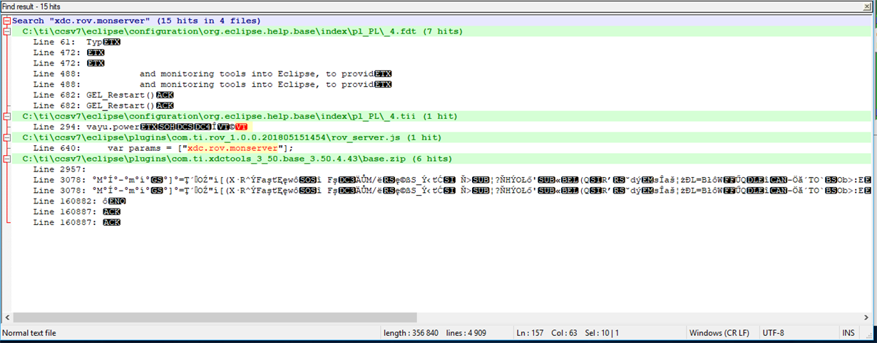

    I just started scanning the c:/ti/ccs7 folder for all files containing xdc.rov.monserver string.
    If I obtain too many files I would be lost.
    Do you have any idea how to fix it?

    below the output of scanning of the c:/ti/ccs7:
    I have only 4 files on the list.
    The rov_server.js concerns.

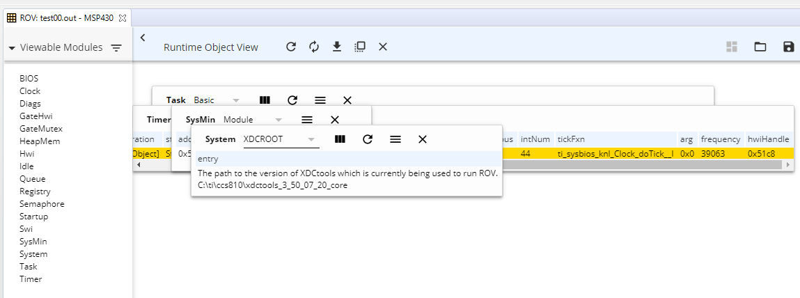

    Then I have found xdctools_3_32_02_25_core and xdctools_3_50_07_20_core in c:/ti/ccs810,
    however CCS 8.1.0 products discovery path points to c:/ti only.
    rov_server.js at line 640 still points to xdc.rov.monserver.
    TI-RTOS and others were automatically discovered except XDCtools 3.32.0.06 which is older than newly installed 3.32.02.25.
    An empty example was created with XDCtools 3.32.0.06 and was automatically defaulted to xdctools_3_32_02_25_core.
    I had to install C/C++ v16.9.8LTS by hand.
    ROV shines!
    I have no idea why Project -> Properties and ROV windows show different xdctools versions.
