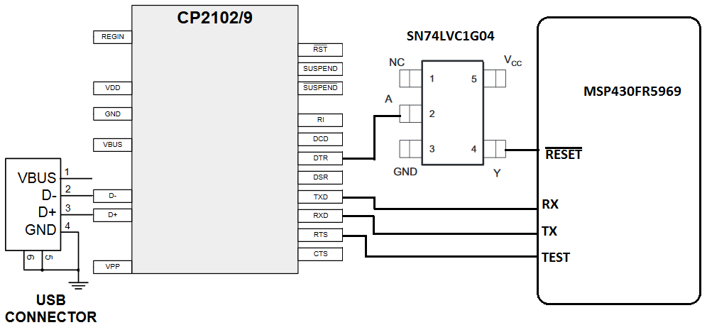

Hi all,
I am designing a custom PCB employing a MSP430FR5969, being programmed using CP2102 in a similar fashion after referring to this blog;
and
and
after going through above links I have developed the following schematic ;
Q1. Is the schematic correct?
Q2. Is connection of DTR (of CP2102) needs to inverted and then connected to RESET of MSP430FR5969?
Q3. Do I need to take care of any other precaution?

  • My first response dealt with the software to be used to flash the FR5969.  I should have also addressed your hardware questions.
    Q1.  The schematic looks correct assuming you need to invert the CP2102 DTR output.  But also see Q3 about the state of these connections when the CP2102 is powered down.  Also, you don't show how the CP2102 will be powered.  The data sheets for the CP2102/9, and for the CP2102N (v1.2 of the datasheet) recommended for new designs, have excellent diagrams for the various powering options.  In any case, I believe you will need to connect the VBUS input back to the USB 5V line, probably through a divider, to enable the CP2102.  My understanding is that the CP2102(N) will not operate at all unless it senses that USB is connected.
    Q2.  The issue of inverting DTR is entirely a function of what software you use to generate the DTR/RTS signalling pattern.  If you can connect a scope to those outputs, the pattern generated when the software starts should look like Figure 2 of Section 3.3.2 of SLAU550P.
    Q3.  Be aware that when the CP2102 is powered down, all of it's I/O  pins become sinks - they behave as though they are connected to ground through a resistor.  This can complicate things if the CP2102 is powered from the USB bus, but the FR5969 is powered from another source.  The biggest problem usually involves the DTR output if inversion isn't needed.  DTR is normally high when idle, but when the CP2102 is powered down, DTR will go low.  If it is directly connected to /Reset of the FR5969, that may hold the processor in perpetual reset, which is not what you want.  While not directly relevant to the FR5969, I posted a long-winded PDF on Github about interfacing a CP2102 to MSP430G parts, and there's discussion about the hardware beginning on page 11 that may be helpful.

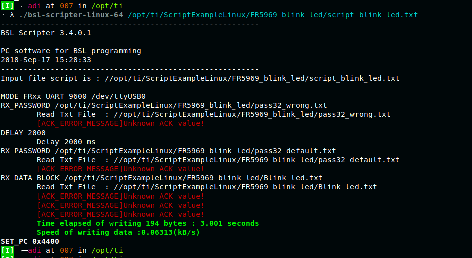

    I was able to generate the BSL invoke sequence mentioned in SLAU550(Figure 2, Page No.- 7) with the following code:
    Link
    But when I tried to run the BSL_scripter after running this, I got the following output:
    I'm using cp2102 with MSP430FR5969 and compiled the BSL_invoke.c with GCC 8.2.1 20180831 under Manjaro Linux.

    Also attached the example script that I used with BSL_scripter
    MODE FRxx UART 9600 /dev/ttyUSB0
    RX_PASSWORD /opt/ti/ScriptExampleLinux/FR5969_blink_led/pass32_wrong.txt
    DELAY 2000
    RX_PASSWORD /opt/ti/ScriptExampleLinux/FR5969_blink_led/pass32_default.txt
    RX_DATA_BLOCK /opt/ti/ScriptExampleLinux/FR5969_blink_led/Blink_led.txt
    SET_PC 0x4400

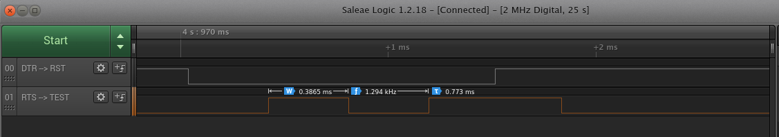

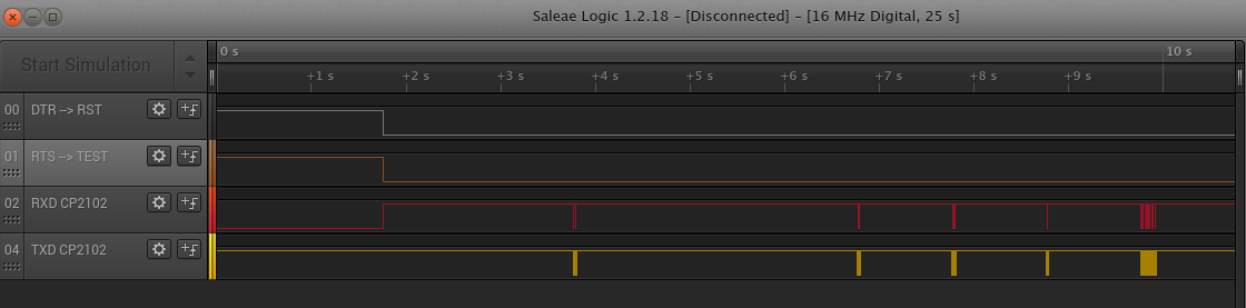

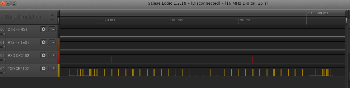

    I checked the signals through logic analyzer. when BSL scripter starts, it pulls down the DTR and RTS lines of CP2102. I have gone through its code, I think it is using libusb for controlling the RTS and DTR lines. We may have to recompile the BSL scripter code to remove that DTR/RTS part.
    When BSL-scripter is transmitting then MSP430FR5969 is giving some reply as shown in the below image(look for TXD and RXD line):
  • George Hug said:
    I wrote a Windows version of your program, and when it exits it leaves the two lines in the correct state - /Reset is high and TEST is low.  But when BSL-Scripter runs, it resets the DTR line, and with /Reset low the processor cannot function.  I got the same error you did, but with no device attached, so I think it's likely that your FR5969 is in reset when Scripter is running, and is doing nothing.
    I have changed the invoke sequence part in the code as the previous one was generating incorrect sequence(Updated the repository). I also found out that tSBW,EN must be between 250ns(slau550p, Page 7, Figure 2) and 110us(MSP430FR5969 datasheet, Page 52, Table 5-35)(Added sleep_us function in the repository to deal with this). But with my code, I wasn’t able to generate tSBW,EN less than 386us(As our systems are multi-threaded so maybe the OS is handling some other process instead of the sleep_us function). Would look for some way to generate accurate timestamps. I haven’t gone through the BSLdemo code, but as you are quite familiar with it and you also mentioned before that it does generate those DTR/RTS sequence, so which system library do they use for that?
    Following is the generated invoke sequence:
    Looks right to me(According to slau550p, Page 7, Figure 2). I also made the TEST line LOW well before starting the invoke sequence(mentioned in slau550p)(This wasn’t there in the previous version of my code). Let me know if there is something wrong with it.

  • Aaditya,
    There is a way to solve this that isn't very elegant, but would not require recompiling Scripter.  You could set things up so the lines connecting DTR and RTS from the CP2102 to /Reset and Test  on the FR5969 could be easily and quickly disconnected or switched off - either mechanically or electronically.  You would first run your program that generates the invoke pattern on DTR and RTS, then disconnect DTR and RTS from the FR5969, then run Scripter.  The /Reset pin should already have an external pullup resistor, and Test has an internal pulldown resistor.  Your program would leave /Reset (DTR) high and Test (RTS) low, which is the normal state for the FR5969, and the pullup/pulldown resistors will maintain that state when the lines are disconnected.  Then it won't matter if Scripter does strange things with DTR and RTS.
    If that's not a practical solution for your project, it might at least be good to confirm that flashing does work with this method using Scripter and a CP2102.
    Edit:  It's possible only DTR would need to be disconnected.  I haven't fully tested it, but if Scripter brings RTS low, and keeps it there, thatmay be ok. If that's the case, it's only DTR going low that messes things up.
    Another solution would be specific to the CP2102N part - the new version.  In addition to the usual UART pins, even the 20-pin package also has four GPIO pins that unfortunately are configured as inputs by default, but can be reconfigured as outputs, and you could use two of them to generate the /Reset and Test pattern, and not even connect DTR and RTS.  But that would require you to configure the chips in advance, and your program to generate the invoke pattern would require the Silabs runtime DLL to be present.  This is a lot of extra trouble, but it seems it should work if you are embedding the CP2102N on your board.
    Of course none of this would be necessary if TI adds the appropriate option to Scripter, as discussed earlier.
