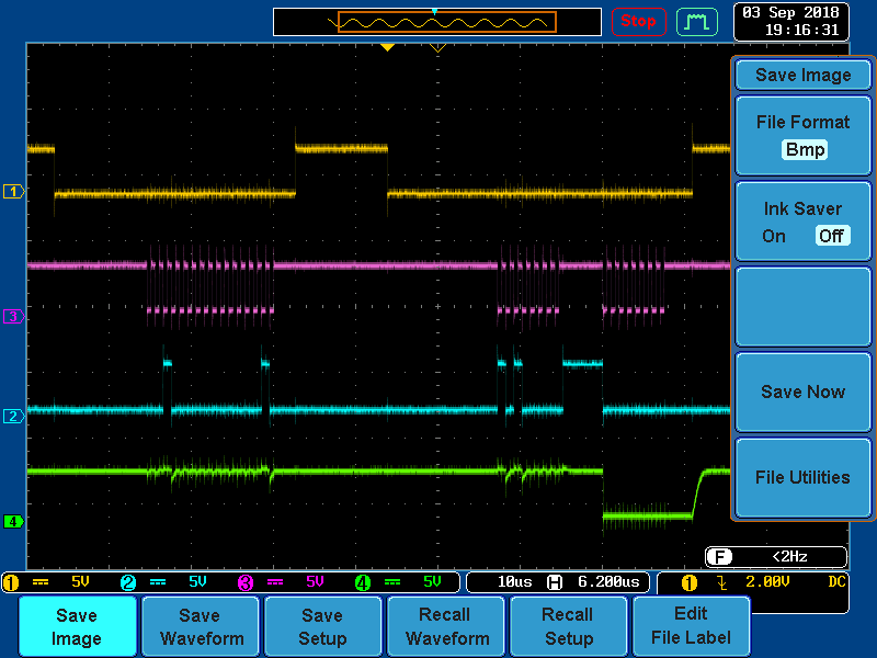

  • Dear Bruce,
    you can have a look at the oscilloscope traces below:
       Yellow -> chipselect
       blue -> MOSI
       pink -> clock
       green -> MISO
    You were right: I was polling on the receive flag indeed,
    while (!SPI_getInterruptStatus(DevHandle->SensorSpiModule, SENSE_SPI_TRANSMIT_INTERRUPT));
    works just as expected:

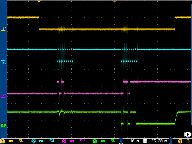

    I was programming the SPI controller to clear receive interrupt flag before sending a byte, and wait for it once the byte was sent. In the end, according to the SPI protocol you can assume slave has completely received a byte once you get one back, right? Well, placing the following code into the readout routine

    gets to the following traces:

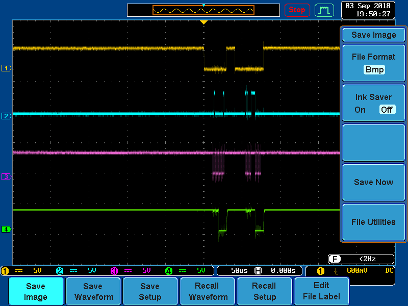

    It didn't seem to be likely that the microcontroller sets MOSI with no reason while resetting or polling an interrupt flag register. So, the last screenshot (3) has been acquired disconnecting sensor SDI from the MCU. The unexpected MOSI signal comes from the microcontroller. Yet, being reset before dummy byte is sent, MOSI glitch should not affect the readout procedure, isn't it?
  • I did some poking with a Launchpad and it does seem that MOSI idles based on the MSbit of the previous byte -- not what I would have guessed, but I don't know how it works inside.
    The difference between the two traces is that in the first you keep the "pipeline" full, so it never idles, and in the second you (appropriately) let the pipeline empty, which results in a pause where MOSI can idle. That is, reading (spinning) on the RXIFG doesn't cause MOSI to go high, it just (indirectly) makes it visible.
    We might see different things if we squint at it, but it looks to me as though MOSI goes low "just in time" in both cases. But even if we suppose it didn't, it would be an unusual device which cares what the contents of the "dummy" byte are.
