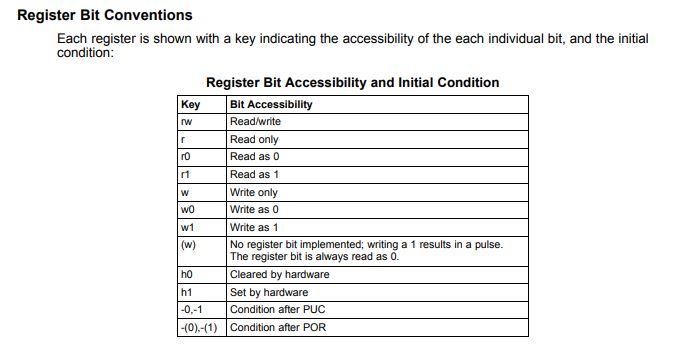

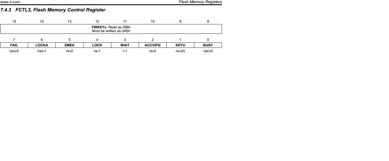

  I am using MSP430F2618, but I did not know what doses the user guide register description mean or different,  such as r(w)-0 , r(w)-1 , rw-0, rw-(0), rw-(0).
MSP430x2xx Family User's Guide page 325, (7.4.3 FCTL3, Flash Memory Control Register ), please help to give explain it, thanks!
