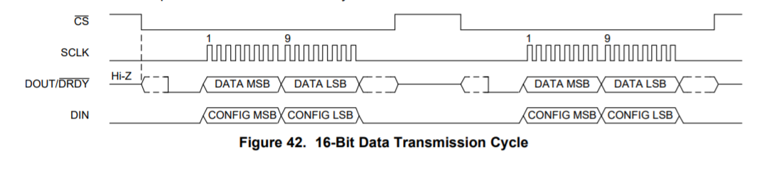

I'm using the MSP430F5529 to communicate to three ADS1118 via SPI.  I'm having trouble reading the output of the ADS1118 since its SPI protocol is somewhat different than a standard SPI protocol.  My MSP430 code (attached) only reads the MSB, and it fails to read the LSB ADS1118 output code.  Any help would be appreciated.
I'm attaching the SPI protocol of the ADS1118.  The MSP430 (master) is writing 0x8F (MSB) and 0xEB (LSB) to the ADS1118 (slave).  I can scope my SPI protocol and confirm this is correct.
I'm also attaching my MSP430 SPI code.
Thanks.

  • Hello Amy,
    Two things that jump out at me so far.
    First, you don't seem to be using the recommended DriverLib code that properly increases VCORE for 16MHz operation in your initClockTo16MHz() function.
    Second, I wouldn't recommend putting your SPI configuration code inside the endless while(1) function. It probably only needs done once. What happens if you execute the following two functions only once? Does the communication happen correctly?
    initSPI(1); //Initialize SPI for ADS1118
    SPI_Master_WriteReg(ADS1118_REG_ADDR_CONFIG_REG_MSB_def, ADS1118_REG_ADDR_CONFIG_REG_LSB, LENGTH_ONE, 6, 1); //Write to and read from ADS1118
    James
  • You're right, for this code, I can put the intSPI(1) outside of the while(1) loop. However, in my overall code, I am actually talking to other sensors (I am not showing it in the code), and the clock polarity for the other sensors is different than the clock polarity for the ADS1118, so I needed to change that every time I talk to ADS1118.
    Anyhow, if I only execute the two functions only once, then no, I am still unable to read the LSB of the ADS1118 output code.
  • You'll want to make sure you're SMCLK is exactly what you're expecting, so please look into setting up VCORE properly.
    Also, have you been following the pseudo code flow provided in Figure 49 in the Ultra-Small, Low-Power, SPI-Compatible, 16-Bit ADC and Temp Sensor w/ Int Ref datasheet? If your CPU is operating at a different frequency than expected and your delays don't match whats recommended, this could be why your communication doesn't work properly.
  • Hi James,
    Yes, I checked against the pseudo code flow, and all looks good. I can see the SPI communication using a scope, so I'm able to check the timing, but my code is not able to capture the LSB data from the ADS1118.
    Also added the code to set up VCORE properly. Thanks.
  • An SPI transaction is an Exchange -- in order to get a byte back, you need to send a byte. Thus,
    > if (mymode==1){
    > uca0_rx_val = UCA0RXBUF;
    > ReceiveBuffer[0] = uca0_rx_val;
    > ReceiveBuffer[1] = uca0_rx_val;
    > ReceiveBuffer[2] = uca0_rx_val;
    This will read duplicate bytes, since you're not sending anything in between.
    Is there a reason you can't just use ReadReg? It seems like all the infrastructure is there.
  • Hi Bruce,
    I see.  So it seems like the MSP430 needs to write CONFIG MSB and read DATA MSB, then write CONFIG LSB and read DATA LSB.
    So far, I've been doing - MSP430 writes CONFIG MSB and CONFIG LSB, then reads DATA MSB and DATA LSB but fails.
    I'll give your suggestion a try. Thanks.
     Hmm,
  • Hello all,
    Ok, the MSP430 sent CONFIG MSB (0x8F), and it is able to read the correct DATA MSB from the ADS1118.  Then the MSP430 sent CONFIG LSB (0xEB), but once again, it is still unable to read DATA LSB from the ADS1118.  Codes attached.
    If I'm sending the second byte, how come I am not getting the second byte back? Scoping the SPI shows the MSP430 is writing the correct values, the ADS1118 is reporting the correct values, and the timing looks good.
    Thanks.

    >>"Unable to read" means UCA0RXBUF__SPI is unable to read the LSB of the ADS1118.
    I'm attaching the ADS1118 SPI diagram, and as you can, the ADS1118 DATA MSB = 0x02 and DATA LSB = 0xC8.  If I run through the code, UCA0RXBUF__SPI keeps reporting 0x02 (the MSB); it never reads 0xC8 (the LSB).
    My ReceiveBuffer[0] = 0x02, and ReceiveBuffer[1] = 0x02.
    >> I'm also attaching a picture the ADS1118 clock polarity, which I think is fine.  If this were wrong, the ADS1118 would not have reported the correct output code.

  • Amy,
    Just so that I understand, does the ADS1118 respond with the proper output? From your scope plot, it looks like the ADS1118 gives the proper DOUT (MISO) response. The readback looks like 0x02 0xC8. On the scope, does the readback ever look like 0x02 0x02 as you're getting from the MSP430?
    The only thing that might reset the DOUT is if the conversions are not synchronized with the communications. For example, if you are in the middle of reading the data, a new conversion completes. Then the DOUT will be updated with the new conversion result. This would cause the reading to restart. Most of the time, we recommend running the device in single-shot conversion mode and then have the master wait the full data period plus 10% for clock variation. For example, if the device is set for 128SPS, you would wait about 8.6ms to read the device.
    If you are running in continuous conversion mode, you want to make sure you start the data read with the DOUT/DRDY transition low. If you do it only by polling, then new conversion data could come up during a read, which could cause a problem in reading SPI data.
    However, if the ADS1118 DOUT always looks ok on the scope, but you're still getting read errors from the MSP430, I would suspect the problem is with the MSP430 or the code.
