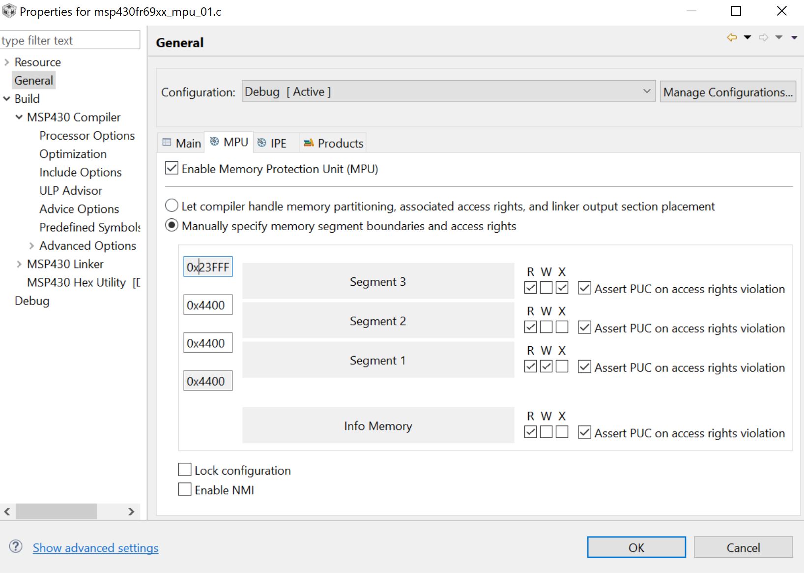

The FRAM area can be divided into three segments.
Is it possible to divide one segment into its own program area and variable data area?
    It's possible to divide one segment. You need to set mpu_segment_border1  = mpu_segment_border2 = FRAM main memory start. You can manually sepcify memory segment bounaries and acess rights in CCS.

  • Thank you for your reply.
    In this method, it become MPUSEGB1[15:0] = MPUSEGB2[15:0].
    In User's Guide(slau367o), It is written by NOTE
    NOTE: The same result is calculated during MAB analysis of segment membership independent of
    whether the higher value is in MPUSEGB1[15:0] or MPUSEGB2[15:0]. If
    MPUSEGB1[15:0] = MPUSEGB2[15:0], Segment 2 is not available and the main memory
    only contains 2 segments.
    Can I change the addresses of 1 and 2?
    I would like to change in the folllows,
    Segment1 : 0x4400 to 0xFF80
    Segment2 : 0x10000 to 0x1A000
    Is it possible?
    Regards.
    Yes, you can change the addresses of 1 and 2. The segment partition you mentioned is OK.
