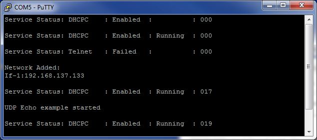

  • Steve,
    Thank you very much for your help with this, but I'm seemingly still running into problems getting the telnet service to run consistently.  Using the stock udpecho example I defined a telnet instance but when I initialize the program I get a "failed" status for the telnet.
    Here is what the UART display terminal displays:
    the main changes I've made to the udpecho sample code are to define an initTelnet function which I call in the ndkStackThread along with the other initialization functions for IP, TCP and UDP.   I also created a second serviceReport function to have the telnet service call which is exactly identical to the existing serviceReport function in the example code.
    Here is the initTelnet function:

    here is the serviceReportTelnet function:

    and here is the modified ndkStackThread function:

    The remainder of the udpecho example code is unchanged.
    I'm assuming that I'm doing something wrong in either the way I've defined the telnet instance, or maybe in how I call the init routine, but I can't seem to figure it out.
    Just in case it helps, I've attached the complete ndk_tirtos.c file.

    /* define the opening console string for the telnet instance */
    char *VerStr = "\nNDK Telnet Console\n";

     *  Function for reporting service status updates.
    static char *taskName[] = {"Telnet", "HTTP", "NAT", "DHCPS", "DHCPC", "DNS"};
    static char *reportStr[] = {"", "Running", "Updated", "Complete", "Fault"};
    static char *statusStr[] =
            {"Disabled", "Waiting", "IPTerm", "Failed","Enabled"};
    static void serviceReport(uint32_t item, uint32_t status, uint32_t report,
            void *h)
        Display_printf(display, 0, 0, "Service Status: %-9s: %-9s: %-9s: %03d\n",
                taskName[item - 1], statusStr[status], reportStr[report / 256],
                report & 0xFF);
     *  ======== serviceReportTelnet ========
    static char *taskNameTelnet[] = {"Telnet", "HTTP", "NAT", "DHCPS", "DHCPC", "DNS"};
    static char *reportStrTelnet[] = {"", "Running", "Updated", "Complete", "Fault"};
    static char *statusStrTelnet[] =
    static void serviceReportTelnet(uint32_t item, uint32_t status, uint32_t report,
            void *h)
                       taskNameTelnet[item - 1], statusStrTelnet[status], reportStrTelnet[report / 256],
                report & 0xFF);

     *  ===== initTelnet =====
     *  Configure a telnet instance
     *  see spru524k_ndk_api_ref p.96
    static void initTelnet(void *hCfg)
        CI_SERVICE_TELNET telnet;
        //bzero(&telnet, sizeof(telnet));
        memset(&telnet, NULL, sizeof(telnet));
        telnet.cisargs.Mode   = CIS_FLG_CALLBYIP | CIS_FLG_RESTARTIPTERM;
        telnet.cisargs.IfIdx  = 2;
        telnet.cisargs.IPAddr = INADDR_ANY;
        telnet.cisargs.pCbSrv = &serviceReportTelnet;
        telnet.param.MaxCon = 2;
        telnet.param.Port   = 23;
        telnet.param.Callback = &ConsoleOpen;
        CfgAddEntry(hCfg, CFGTAG_SERVICE, CFGITEM_SERVICE_TELNET, 0,
                    sizeof(telnet), (unsigned char *)&telnet, NULL);

    I hope you can point me to whatever it is I'm still doing wrong.
    Thank you
    Patrick
  • Well,
    I never got the telnet service to operate reliably.   I worked around the issue by defining my own connection socket and interface console.
