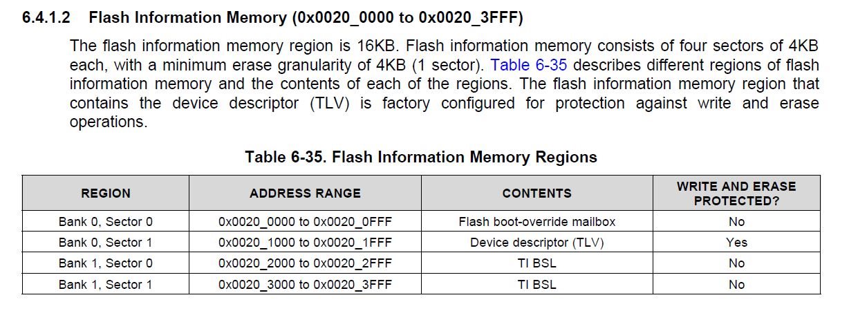

I need to store user setting data on the msp432 flash during run time instead of an EEPROM.
The msp430 platform flash has dedicated segments (A through D) where user data can be stored without running the risk of corrupting main memory.
But going throught the msp432 datasheets as well as the example codes and ti forums could not find any safe bank / segment, which would not risk corrupting main program/code memory.
The examples use main flash area to store user data. Not sure how to decide i should position my data.
Regards & thanks in advance
sohrab
  • The information memory in bank1 is the TI BSL.  If this is not needed, then you could erase the BSL and use this memory for the storage of user setting data.  You could also get creative and reuse the Flash boot-override mailbox ( Information memory Bank 0, Sector 0) but you need to make sure that the first couple of bytes indicate that there is no pending message in the mailbox, so that the boot code does not try to access and/or apply the information in the mailbox location.

  • I think that placing the values in the last last sectors with that much space in between is safe.
    I do not quite follow the references to the TLV. The Flash size is stored in the system control register SYS_FLASH_SIZE. The Flash information found in the TLV is related to the programming of Flash. Since you mentioned that you are only using ½ of the Flash space that reminded me that the over-the-air update (OAD) example does something similar in that the application code resides in bank 0 while the new image for updating is kept in bank1. The linker command file is a great example of how to place pieces of code in specific places.
