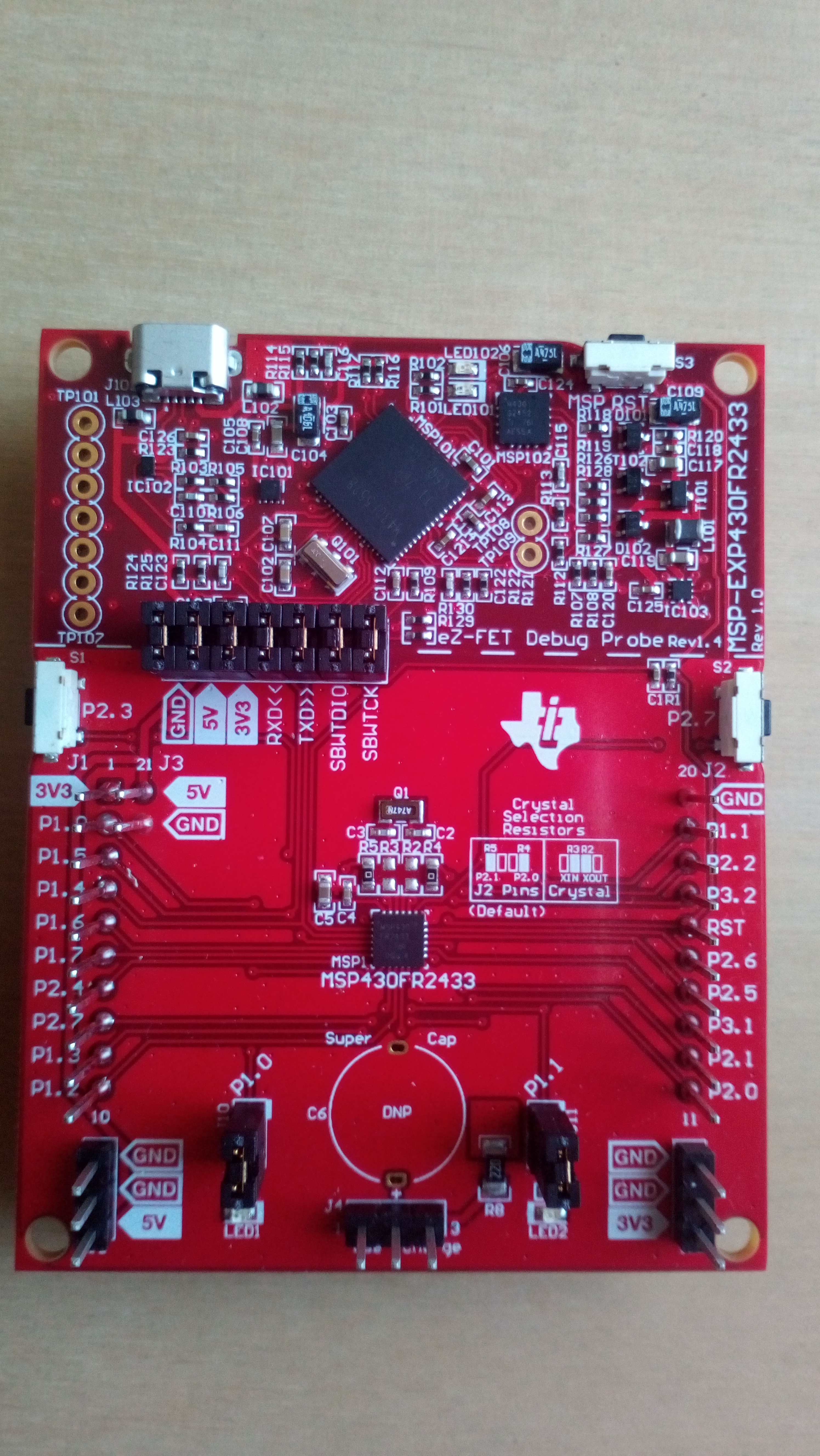

My MSP430FR2433 LaunchPad doesn't appear in Device Manager after connecting USB to PC. I only hear the connection sound. Tried to change cable, different USB ports and even PC - no result.
Only green LED102 lights up on board.
Any ideas?

  • Do you have any external circuits attached to the LaunchPad?  Or, any jumpers added that are not in their default locations?
    I'm trying to determine if there is a possibility of a short somewhere that could be preventing the debug circuit from enumerating properly on your host computer.  Since it did enumerate at one point, I'm inclined to think that the debug circuit was programmed correctly (otherwise it never would have enumerated).
    Walter
  • Nothing has been added to LP. Jumpers are in default positions (see pic. attached).
    Also, should be noted, that trying different cables it was a bit different.
    With original cable even green LED102 doesn't light up. Trying another cable (a bit longer) at least this LED turns on.
    Artur
  • Interesting. I've got two possible theories on this:
    1. The cable which shipped with the board worked initially but has now failed somehow, and it failed in such a way that the PC has blocked the device from enumerating going forward because it thinks there is a problem with the device. Even when you try a good cable, the PC thinks there is an issue with that device (and/or the USB port it is connected to) and it blocks it still. If this is the case, you might be able to fix this by disconnecting the board from your PC, restarting your PC, and connecting the board again using a KNOWN GOOD cable (like the one you use where the LED illuminates). You may also try this with different USB ports if you have different ports available. I've had this issue before where if I have an overcurrent situation on a board the PC can block it and I need to restart or move it to a different port to get the PC to allow the device to connect again.
    2. If #1 doesn't work at all, there may be a hardware issue with the board. In this case, you'll want to follow up with the supplier for the board to get a replacement. If you purchased the EVM from the TI Store, you can contact the TI Store and explain your issue (referencing this thread) and they can set you up with a replacement. If you purchased it through distribution, you'll need to work with the distributor you purchased the board from.
