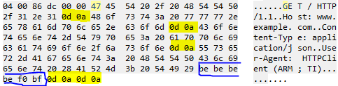

  • Using the above code, the following is a screenshot of the header packet captured by Wireshark:
    The blue marker is just the hostname and path. At the end of Content-type: application/json, there is an extra space denoted by 0x20 and 0x19 which is identical to unicode \u0019, end of medium. User-agent has an extra 4 spaces followed by a 0xF0 and 0x18. The body is sent in another packet and seems to be fine.

    The following is my wireshark log. As you can notice the highlighted text is the end of lines. This seems to be right. The only extra characters are the one inside the blue box (be, be, be, be, f0 and bf). I will check to see why these are being sent, but not sure if these cause an issue.
