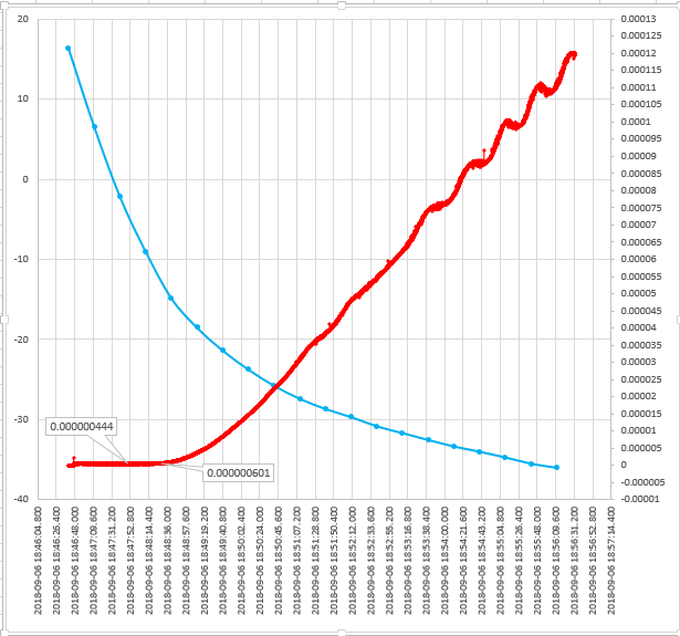

I am working on an msp430f2274-ep where we need to be able to run down at -40 and -50C.   When testing the 2274 in a chamber on a small demo board (modified ez430-rf2500 stripped down to only msp430 and a 32.768Khz xtal) we start getting a current ramp around -15C that continues upwards as we cool.  See graph below for data point plotting.  We are using a keysight B2901 for current measurements and a 34792A DAQ to record temperature right on the outside of the package  (K type thermocouple taped to the top of the msp430 with kapton tape)
We tried a board without conformal coat and one with conformal coat, no change in current draw.  This happens across the multiple samples we have built up.
What test artifacts (testing, code, results) does TI have to support the LPM3 current draw maximum of 1.5uA down to -55C as stated in the datasheet?
What might we be doing wrong, either with the XTAL or VLO (we have tried both) that is causing this problem?

  • I'm not sure if I understand your graph.
    What are the blue and the red lines?
    Where is the power consumption plotted?
    I also don't see the mentioned code.
    Lukas
  • The red line is currrent draw, the blue line is temperature.  Code seemed not to stick, lets try that again!

    I just took a random F2274 unit and measured the current consumption by using your code (VLO).
    I see over your temperature range a value of 0.6uA matching very well with the Datasheet.
    It seems to be an issue with your setup.

  • Hi Lukas,
    Thanks for the quick response.  Did you go to -35C?  Until we get down to -10 or -15, the current is stable, then it goes up (as the graph shows).   However at room temp, of course, current draw is fine.
    Was this on a F2274-EP device?  Can you run down to -55C and if its possible provide a current draw graph?   How are you monitoring the current draw?
    P1 has a button attached so we can simulate an interrupt if we wish to do so and exit LPM3.
    P2 I think the intent was to just set P2.0 for input, not all the ports.

  • Hi Charles,
    I measured the current down to -55C, there was no change.
    The graph would look like a straight line at 0.6 uA.
    I put an Amperemeter between the power supply and the DVCC pin.
