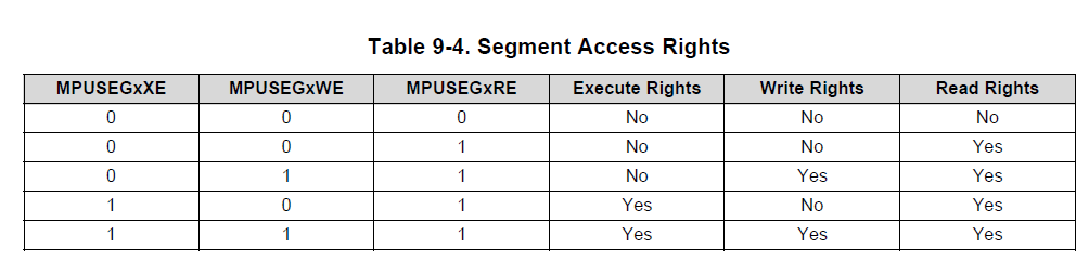

Looking at the current user's guide (slau 367 o), I divide the FRAM segment and write and protect it.
FRAM area can be divided / written by the following program.
 WDTCTL       = WDTPW | WDTHOLD;
 PM5CTL0 &  =  ~ LOCKLPM5;
 MPUCTL0H  = 0xA5;
 MPUCTL0    = MPUPW;
 MPUSEGB1 = 0x0F80;
 MPUSEGB2 = 0x1A00;
 MPUSAM & = ~MPUSEGIWE;
      MPUSAM = MPUSEG1RE | MPUSEG1XE | MPUSEG1WE |
                          MPUSEG2RE | MPUSEG2XE | MPUSEG2WE |
                          MPUSEG3RE | MPUSEG3XE | MPUSEG3WE |
                          MPUSEGIRE | MPUSEGIXE | MPUSEGIWE;
After that, although it tried to take a protot with the following setting, the register value on CCS is invalid but it is written.
  MPUSAM & = ~ MPUSEG1XE;     // Disable execution
  MPUSAM & = ~ MPUSEG1WE;     // Disable writing
  MPUSAM & = ~ MPUSEG2XE;     // Disable execution
  MPUSAM & = ~ MPUSEG2WE;     // Disable writing
Which register can be set to disable writing?
