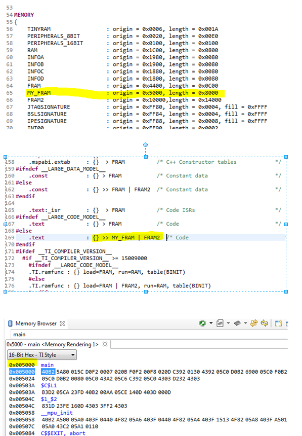

I am using CCS to create a program of MSP430FR6989.
Currently the text section is allocated to H'10000.
I'd like to change the text section address.
For example,
.text H'05000
I want to place it in the address as shown.Now I have confirmed the MSP 430 optimized C / C ++ compiler user's guide.
The NOTE in 6.1.3 states that the CODE section is automatically allocated by the linker.
Are each section located at a fixed address and can not be changed?
