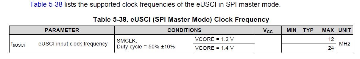

I have a spi configuration code which is written for a msp430 and DAC161S997. But i am trying to use it on my msp-exp432p4111. I think the problem is UCB0BR0 register. The register that i found(BRW) has different use.
msp430 code
	UCB0CTL1 |= UCSWRST;                                                       // Enable SW reset
	UCB0CTL0 |= (UCMST + UCMSB + UCSYNC + UCCKPH);                             // SPI Master, 3 wire, synchronous mode
	UCB0CTL1 |=  UCSSEL_2;                                                     //SMCLK
	UCB0BR0 = 8;                                                               // SMCLK/8 = SCLK (1MHz)
	UCB0BR1 = 0;
	UCB0CTL1 &= ~UCSWRST;                                                      // Clear SW reset, resume operation
the code i have made
	EUSCI_B0->CTLW0 |= EUSCI_B_CTLW0_SWRST;                                                       // Enable SW reset
	EUSCI_B0->CTLW0 |= (EUSCI_B_CTLW0_MST + EUSCI_B_CTLW0_MSB + EUSCI_B_CTLW0_SYNC + EUSCI_B_CTLW0_CKPH + EUSCI_B_CTLW0_UCSSEL_2);     // SPI Master, 3 wire, synchronous mode
        EUSCI_B_CMSIS(EUSCI_B0_BASE)->BRW = 48000000 / 1000000;
	EUSCI_B0->CTLW0 &= ~EUSCI_B_CTLW0_SWRST;                                              // Clear SW reset, resume operation
