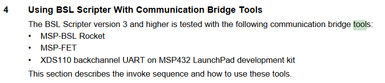

  • Hi Penny,
    Are you just using the BSL scripter directly with the Launchpad? You might need a communication bridge.
    The MSP430 needs to go into BSL mode to respond to BSL commands. To set it into BSL mode, you need to send a sequence using the TEST and RESET pins (as described in www.ti.com/lit/pdf/slau550).
    The BSL scripter sends a "command" to a communication bridge to generate such sequence, but the Launchpad doesn't have support for this feature, so it's not generating the BSL sequence. As a result, the MSP430 is just not going to BSL and it doesn't respond any BSL commands.
    The BSL Scripter User's Guide () describes some tools which can be used as communication bridges:
