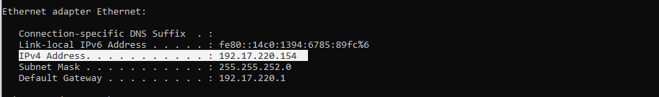

  • Hi Neiz,
    I could reproduce your problem and then found out that the IP address given is wrong. my apologize to reply this really late, as i was out of office for some time.
    when you type "ipconfig" in your command prompt, this what would you see under LAN
    Ethernet adapter Local Area Connection:
       Connection-specific DNS Suffix  . : fritz.box
       IPv6 Address. . . . . . . . . . . : 2a02:810d:4ac0:5bfc:94de:c6ec:9dda:d8d2
       Temporary IPv6 Address. . . . . . : 2a02:810d:4ac0:5bfc:e184:7f32:6f8d:7ea0
       Link-local IPv6 Address . . . . . : fe80::94de:c6ec:9dda:d8d2%11
       IPv4 Address. . . . . . . . . . . : 192.168.178.80
       Subnet Mask . . . . . . . . . . . : 255.255.255.0
       Default Gateway . . . . . . . . . : fe80::ca0e:14ff:fe88:85ae%11
                                           192.168.178.1
    Choose the IPv4 address as your IPServer in the script file. then I choose another IP 192.168.178.82 to be the IPClient.
    other than that, there is a possibility that the UDP packet transfer is protected by the firewall. https://www.windowscentral.com/how-open-port-windows-firewall usually when you run the BSL Scripter for the first time, there is a pop up window to execute the application.
    I hope this is also a solution for you.
    don't forget to mass erase the device before running the script_1.txt. Mass Erase could be done by:

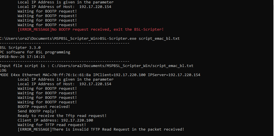

    I am running into the same error mode of the BSL Scripter. This is what I get in my prompt:
    This is my ipconfig so you can see the ip is correct:
    I have tried several things like changing the firewall configurations to allow the application and changing the client ip. None of them have worked. Something interesting that you can notice in the first image, is that the first time I run the BSL-Scripter it fails by not receiving a BOOTP request. The second time is the same error that Neiz has.
    Just to add, I am using a local network with just one switch and no access to a router. Is this important? Is it necessary to have such device for dynamic IP allocation? My initial guess is that it isn't necessary cause this allocation is already done by the BSL Scripter, but it is good to ask.
    Any other suggestions of what could be the issue?

  • I have been using the XDS110 (MSP-EXP432E401Y) to program a blank image and power the system.  With no source code present the boot code thinks the device is blank and initiates the BSL.
    I would recommend updating to the latest BSL.  I did have some success with the first two scripts found in the BSL example but I am still working on the third.

    I am running into the same error. This is what I get trying to run script_1.txt(provided in the Examples folder):
    As you can see I'm using BSL Scripter 3.4.0.1. I also erased the memory of my launchpad before running this script.
    Any suggestions?
                                           192.168.178.1
