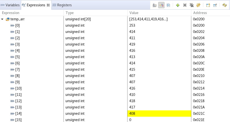

temp_arr[counter] = ADC10MEM;
// Increment counter
counter++;

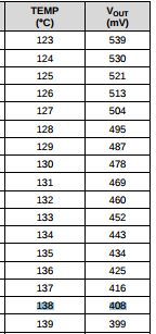

The voltage returns do not correspond to the ambiental temperature:
What am I missing?
According to the documentation, 408 mV translates to 138C.
