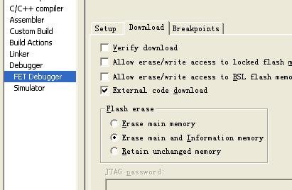

    We are now developing a product whose supply voltage is 1.5V,so we pay a great interest on L092。
    I prepared two questions for U,and hope U can do me a favor.
    1st.  Is The application code downloaded to EEPROM by FET430-UIF directly?
    As I know ,the MSP430L092 doesn't consist of any Memory(such as ROM or Flash )for User code,and the user code must be download into the external EEPROM,so how or in what way ?By the UIF?
    2nd.how to Emulate my code with the Development Tool that TI provided?
     I have fixed the Jumper in the TargetBoard MSP-TS430L092 and the L092 Active    cable according to 《MSP430 Hardware Tools User's Guider》(slau278e).
     Because of the Net problem,I can't upload all  the screenshots of My IAR (V5.10)configuration .I chose the one which I
    think is the most important.
     I don't know if my fault configuration lead to the failed emulation ,So could U give  me some ideas on the IAR  onfiguration or other factors which will help sovle the problem.
    Thank you very much.

  • Benny,
    1. When debugging the L092, you can download the code into the L092 RAM [dedicated RAM for application code, called LRAM] and the device will run/be debugged as long as power is applied [RAM is volatile]. Uncheck the 'External Code Download" checkbox [shown in your screenshot] to instruct download to RAM.
    Alternatively, you can download the code into the EEPROM [non-volatile memory], which retains the firmware after power out. The flow for this option is as follows. The MSP430USB-FET controls the L092 via JTAG, and uses the device's PWM pins & shared JTAG pins to power up the EEPROM and enable SPI communication. So in a way, it is an indirect path from the PC to L092 to EEPROM when it comes to firmware downloading into the EEPROM. The settings that you have [shown in the screenshot] are correct  for this option.
    During this code download process, you might notice the LEDs will blink a few times, indicating the power converter and/or SPI communication at that time.
    2. Once you download the code into the L092 RAM or into the EEPROM, the IDE (in your case, IAR) will retain the control of the device, allowing you to start debugging your application. You can use the code example that you selected to test the function of the device.
    Hope that helps!
    ~Dung
  • Hi Dung,
    I have solved my problem. It 's not because of my incorrect IAR configuration, in contrast,I  guess it  should be a bug of L092 in different bath or chip version.
    in Engineering samps,XL092  REV A ,I can suceed in debuggering the code with the Development Tool (TI provided).however, if I use L092 REV D, I 'll failed.
    The most interesting thing is that if I first debugger a code in a XL092(REV A) ,then i can also succed in download the code into  L092 REV D, can U help explain
    this?
    Thanks.
    -----Benny
  • Benny,
    sorry for the super late response. This thread got buried in the E2E forum and just by sheer coincidence that I found it again.
    We have seen the behavior replicated in a similar situation where a Rev.D device has to trick the USB FET before download/debug can be started. We're still currently investigating the issue and I will update once we have more information or find a solution.
