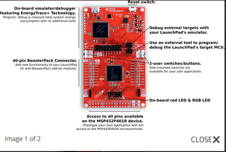

Dears,
Is it possible to use the remaining 2 hardware UARTs on MSP-EXP432P401R-MSP432P401R LaunchPad?
Looks like there are no pinouts on those two additional UARTs.
Stanislav

Stanislav,
Using the extra pins on the bottom of the LaunchPad as shown in Tomasz post is one way to do this.
Another way is to remap the pins on the Boosterpack header to the UARTs you wish to use. Have a look at the PMAP (Port Mapper) example here to see how to do this. (the example shows moving another peripheral, but you should be able to get the general idea).
