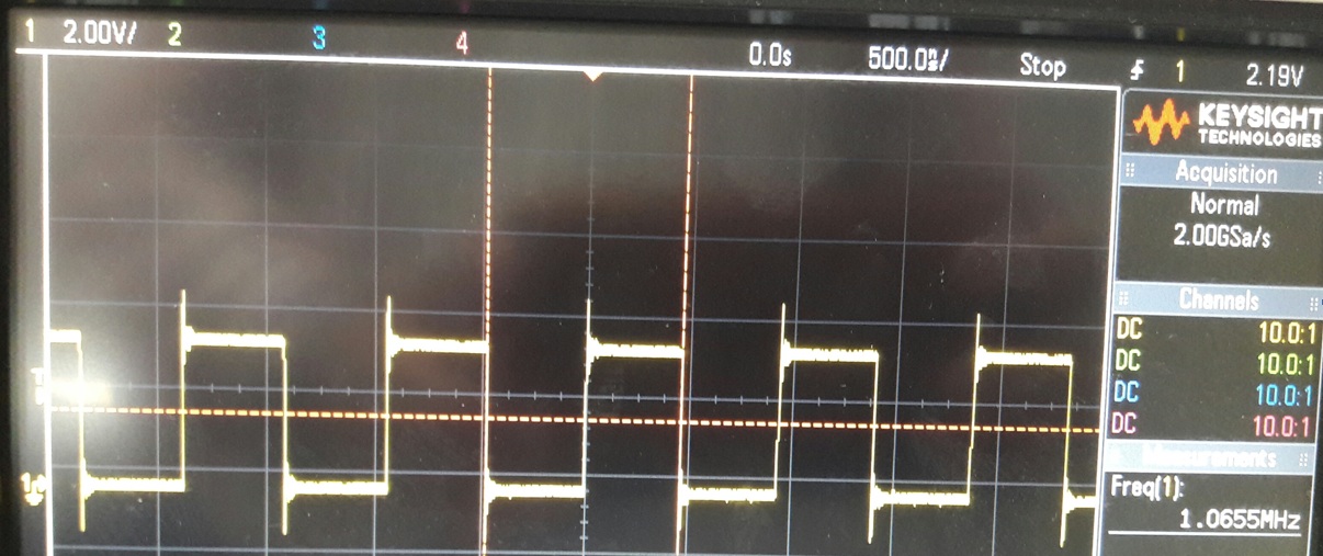

Hi All,
I have connected 4MHz crystal at controller's XT2 pin & 32.768KHz at XT1 and configured accordingly. If I configure SMCLK / MCLK with this 4MHz crystal the output comes with 1MHz.

If i see at P7.7 using oscilloscope, it shows pulse of 1MHz instead of 4MHz. I am unable to find the solution.
But if I configure all three clock source with 32.768KHz, then all these three pins (P7.7, P1.0 & P2.2) have perfect 32.768 KHz signal.
All test are done using MSP430F5529 development board.

  • Hi Jace,
    I have copied your suggested code example as it is and checked the output frequency at P7.7. But the result is same with 1MHz. I have again checked with same arrangement after about 30 minutes, the frequency is same at 1MHz.

  • Hi Jash,
    With your example code I am able to get 4MHz frequency out. Actually today I have missed to set debugger mode because of this the old code was running.
    Thanks for your support. Now i will implement the required changes in my project file.
