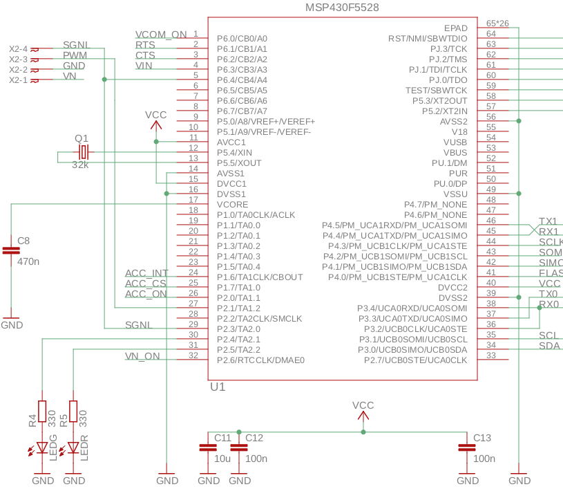

Some time ago I built a prototype (say prototype No 1) of a simple, straight forward, system built around a MSP430F5528 (schematics below), this prototype worked at once and I have so far not found any issues.

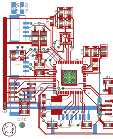

Recently I had to make some changes, mainly on the PCB. I have redrawn the schematics (also provided below) and the board and built a new prototype (say prototype No 2). When I connected this prototype to power it consumed a lot of current (couple of tens milliamps) and this consumption gently built up to hundred, two hundred milliamps even hundreds of milliamps in more or less a minute.
Of course I have checked schematics and PCB over and over but did not find any reason for this issue.

Prototype No 1
Prototype No 2
Prototype No 2 PCB (part):
  • Based on this schematic snippet no obvious failure can be seen the question is did you aligned the SW according to the different connected GPIOs.
    Proto #2 is not used USB right while hope this is considered in SW as well.

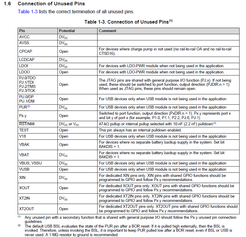

  • When unconnected pins are configured as inputs (the default), the floating voltage can partially activate both complementary transistors, and the cross currents will increase power consumptions greatly. Unused pins must be configured as outputs (see table 1-3 in the User's Guide), or as inputs with pull-up/-down.
    correct all pins requires termination either you configure them output high/low or input with pull up/downs enabled.
    Any floating GPIO (also JTAG pins) contributes to current consumption. And TI does not recommend to leave unused ports open in the users guide following table defines how terminate unused pins:

    Yes, I believe that all pins are correctly terminated since this table indicates only Vss and Vcc connections for power pins and most other pins can be left open, which is the case. The only exceptions I can see might be:
    PUR - this pin is indeed left open, I tried on one device to ground it with a 1M resistor, this did not fix the issue, but it might be already too late for these devices,
    RST - at first trial I put the pullup resistor in place, but I suspected external components could be the cause of the issue so I removed everything,
    XT2IN - indeed not connected to VSS as a XTAL is planed.

    Can you get any information on the 'extra' contacts that appear on side of the RGC package near the edges ?
  • The easiest way to find a short, i.e., the location where the most current flows, is with a thermal camera (or alcohol, or freeze spray).
    Alternatively, use a sensitive voltmeter to measure the voltage drop along the tracks.

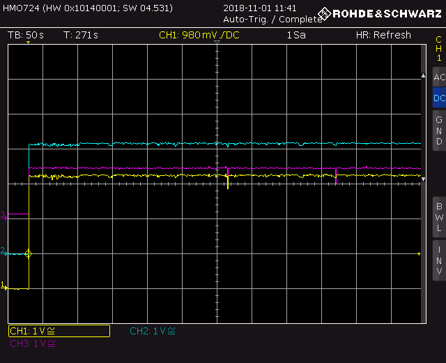

    I have built two additional prototypes in order to measure and log the current, Vcc, Vcore and Reset.
    The peak current did not raise to the same amounts as what I have measured before, although it is still abnormal:
    Below, Vcc (yellow), VCore (pink) and reset (blue), I believe the ripple is due do the current variations (see below).

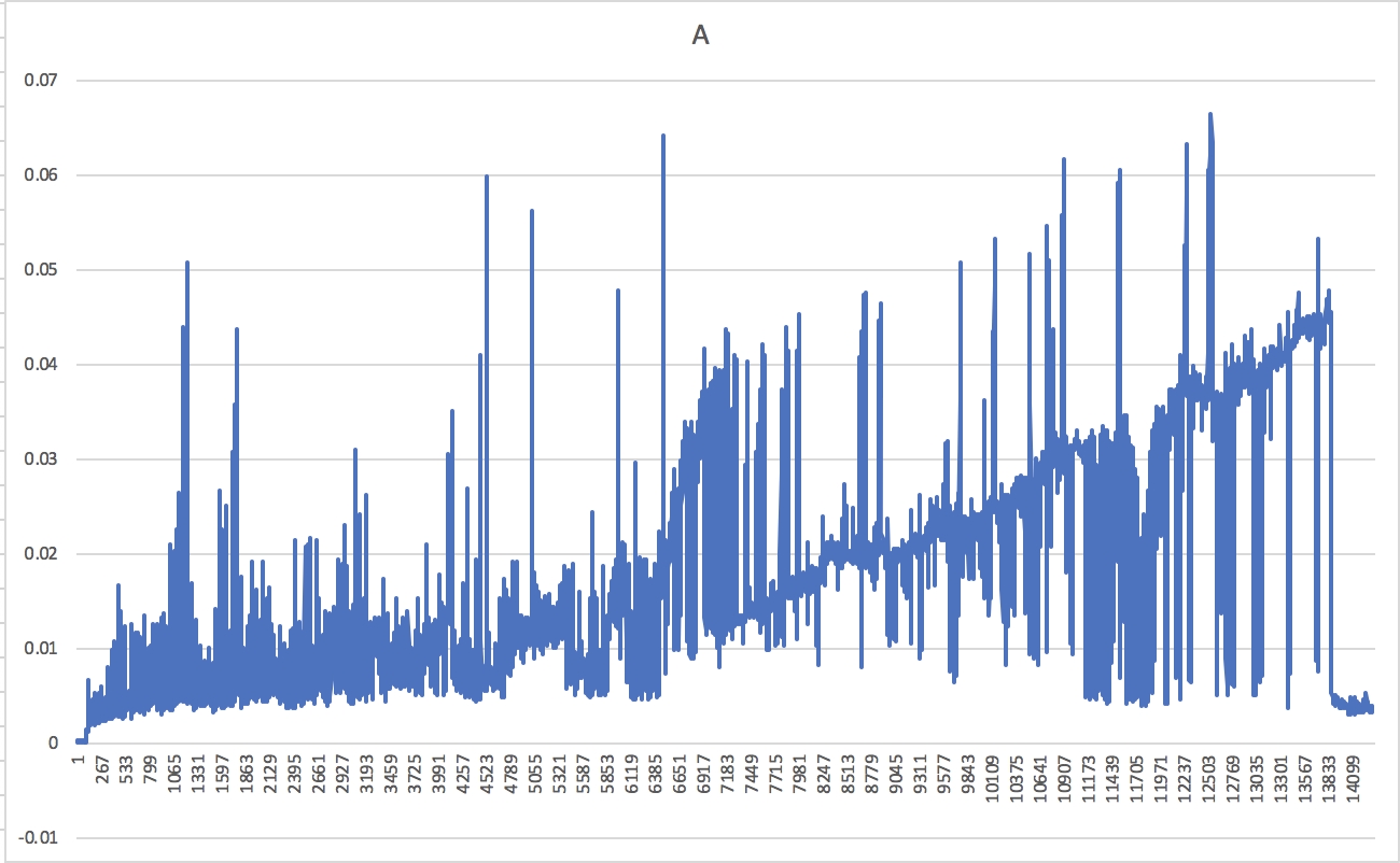

    This is the current measured over more or less the same period in Amps:
    There are some peaks at more then 60mA, in y previous observations I would see ore or less the same scheme (oscillating but increasing current) but it would grow much quicker.
