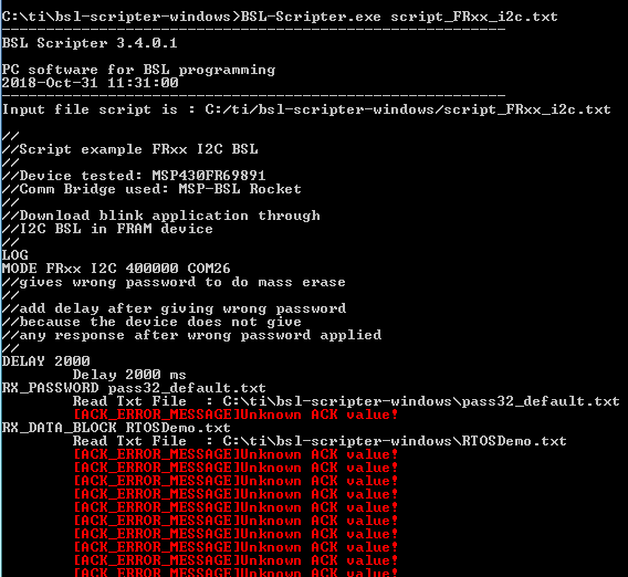

I am using MSP430F5239 and my system requires an I2C BSL for upgrading the firmware in the field. We figured out that the default BSL in this device is timer based UART and we would need to flash a custom BSL before shipping it to our customers.
Progress so far:
To create a custom BSL, we planned to use,  "MSP430BSL_1_01_00_01" provided as a reference.( CCS_v7_MSP430F522x_I2C project to be more specific.)
We figured out that "Lite FET-Pro430" was the best software to load BSL. Before starting to change the BSL project for our MSP430 device, we decided to give a shot with the default build provided with CCS_v7_MSP430F522x_I2C. To confirm if BSL was loaded correctly and is running, we sent I2C some write commands with slave address 0x48, and we saw MSP430 respond. So, we are pretty sure that we have got the BSL loaded correctly.
Is there any better suggestions that you recommend us to follow in the above steps?
Main problem:
Our next step was to load our final application binary using BSL. we came across command lime mode of BSL scripter for PC based loading, using FET Programmer.
BSL-Scripter.exe -n 5xx -i [COM26,I2C,100000] -b -w RTOSDemo.txt -v -z [SET_PC,0x4400]
We were getting an error stating, "The communication protocol chosen is not available for the chosen Family!". So we decided to look for alternate methods and came across "SimpleLink Host for MSP430 UART BSL". (Embedded programming solutions for BSL). We found host implementations only for UART and not for I2C.
Please let us know how can we proceed further. Also please share if there are any other host firmware implemented using I2C with MSP430F5229(the one used in USB2ANY)

  • Hello Raja,
    What is the HW connection between the MSP and your PC? Is it an MSP-FET or MSPBSL-ROCKET?
    Let's continue below to help figure out your BSL communication issue, but I do want to point out is an easier way to get both your application and BSL image onto the device. I would recommend compiling both your BSL and your application images separately, then manually combining the binary image (the .txt file). This should work and is easy to do for most situations as the BSL and application areas do not overlap. Then you can program the combined image onto your device at the same time. This should save you programming time and steps while in production.
    To help with the BSLScritper usage, I would recommend placing your commands into a script file and run the script via the command line. This way you get a printout of every step the BSLScripter tries. You can also turn on VERBOSE on the script to get extra debug information. You can then take screenshots or copy the text here so we can debug.
  • Hi Jace,
    Thanks for your suggestion of bundling both BSL and application FW as a single .txt file.
    HW connection currently used  is MSP-FET.  But our final solution would required an embedded system to upload code via BSL (another MSP430 device - MSP430F5239). Since, we are not using the default BSL and updating it with custom BSL, we dont want both the sides (host and devices) to be untested.
    Testing the custom I2C BSL with BSL Scripter and MSP-FET would be our first step. Once the custom BSL is tested to work well, we would need to start with Host implantation to load FW via BSL.
    When testing with BSLScripter, we got the below error:
    Error: The communication protocol chosen is not available for the chosen Family!
    I feel BSL scripter only supports loading using default BSL of all families. is there a way to workaround it ?
  • Hello Raja,
    I've conferred with our Tools time and it does seem that the BSL-Scripter won't validate use of I2C protocol in regards to F5xx devices. This has been added as a feature request for future release. In the meantime, you can use the FRxx designator in your script as these devices do validate the I2C protocol and they use the same protocol and invoke sequence as the F5xx devices.
  • I followed the suggestion that you had mentioned and below is the error i got.
    "unknown ack value"

  • Raja,
    After your mode command, can you add the VERBOSE command as well?
    One thing that i think might be happening. By using the default password file, you are assuming the device has been gone through a mass erase. So the steps above are actually mass erasing the device as the "default" password supplied is a wrong password. (you sometimes get ab Unknown ACK value error when mass erasing.) the BSL is still locked at this point, so the RX_DATA_BLOCK command will not work. Try repeating the RX_Password command so that you give it a wrong, then default password to unlock the device.
    As an extra precaution, don't use the 400kHz for I2C at this time and step down to 100kHz until you get good communication. Also take a look at the I2C lines with an O-scope and logic analyzer to make sure that communication is solid. What pullup resistors are you using for I2C?
  • Hi Jace,
    You were correct. There was a mass erase that was happening.
    But I figured out the BSL example code supplied was using the main memory location as well (in addition to BSL space). So a mass erase was causing the BSL to malfunction. I was able to reduce the size of BSL by removing few features and able to fit BSL within the 2KB BSL space. I am able to load the my application firmware now.
    Thanks for your prompt support.
