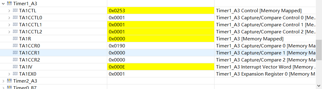

Hi, I am using TDC1000-TDC7200EVM with MSP430F5528, when I want to use the timer1_A, I have some problems:
Here are the codes I use to initial the TIMER1_A3:
I changed INTERVAL_100ms=50.
When I started to debug, here are the value of registers:
Initial the TIMER:
TA1R = TA1CCR0:
TA1R is reset to 0:
TA1IV did not change so that there is no interrupt.
What can I do?

  • Hi Britta,
    I found I did not enable the interrupt TAIE. I added  '__bis_SR_register(GIE);' , and it works.However, here is the register value when the TAIFG=1:
    The TA1IV changed, but the program did not jump to the interrupt program. The interrupt vector is TIMER1_A1_VECTOR        (48 * 1u) .
    What should I do?

  • Hi Britta,
    Yes, the interrupt occurs but it doesn't jump to Timer1_A1 isr. Actually,if I set a breakpoint in the Timer1_A1 isr, the interrupt will occur. However, when I use 'step over' to run my program step by step,  it will not jump to isr.
    Here is my code:
