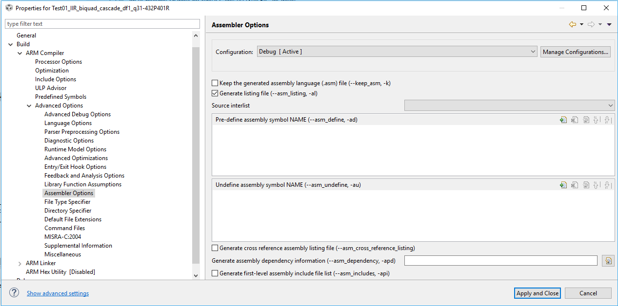

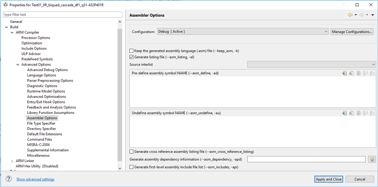

    Too bad the wording "listing" does not appear in the CCS User's Guide.
    Assembly feature is a compiler feature, not CCS.
    --asm-listing feature is an old feature on UNIX/Linux world.

  • Thanks for the insights. I was able to create a listing file and saw that that the GPIO write results in 3 assembly language instructions. Maybe a register-register add can be dome in one clock cycle, but not these instructions. I updated my data with the assembly code on the far right if you care to take a look.
    -Jimmy Z

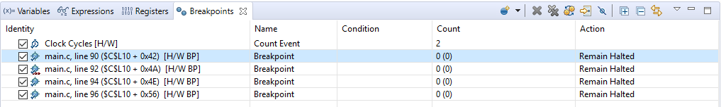

    Debugger Clock Cycles feature shows 13 cycles to execute first and second statement.

  • At full speed of 48 MHz with the test code:
    /* --COPYRIGHT--,BSD
     * Copyright (c) 2017, Texas Instruments Incorporated
     * All rights reserved.
     * Redistribution and use in source and binary forms, with or without
     * modification, are permitted provided that the following conditions

    gives the following disassembly:
     88           P3OUT = 0x00;
    0000029e:   F6444022            movw       r0, #0x4c22
    000002a2:   F2C40000            movt       r0, #0x4000
    000002a6:   F880B000            strb.w     r11, [r0]
     89           P3OUT = 0x01;
    000002aa:   F880A000            strb.w     r10, [r0]
     90           P3OUT = 0x00;
    000002ae:   F880B000            strb.w     r11, [r0]
     91           P3OUT = 0x01;
    000002b2:   F880A000            strb.w     r10, [r0]
     92           P3OUT = 0x00;
    000002b6:   F880B000            strb.w     r11, [r0]
     94           P3MAP01 = 0x00;
    000002ba:   F8A0B3F6            strh.w     r11, [r0, #0x3f6]
     95           P3MAP01 = 0x01;
    000002be:   F8A0A3F6            strh.w     r10, [r0, #0x3f6]
     96           P3MAP01 = 0x00;
    000002c2:   F8A0B3F6            strh.w     r11, [r0, #0x3f6]
    100           MAP_SysTick_enableModule();
    The Clock Cycles Counter shows 2 MCU clocks between lines:
    90 and 92,
    94 and 96.
    Optimization settings:
    It got what I expected!
