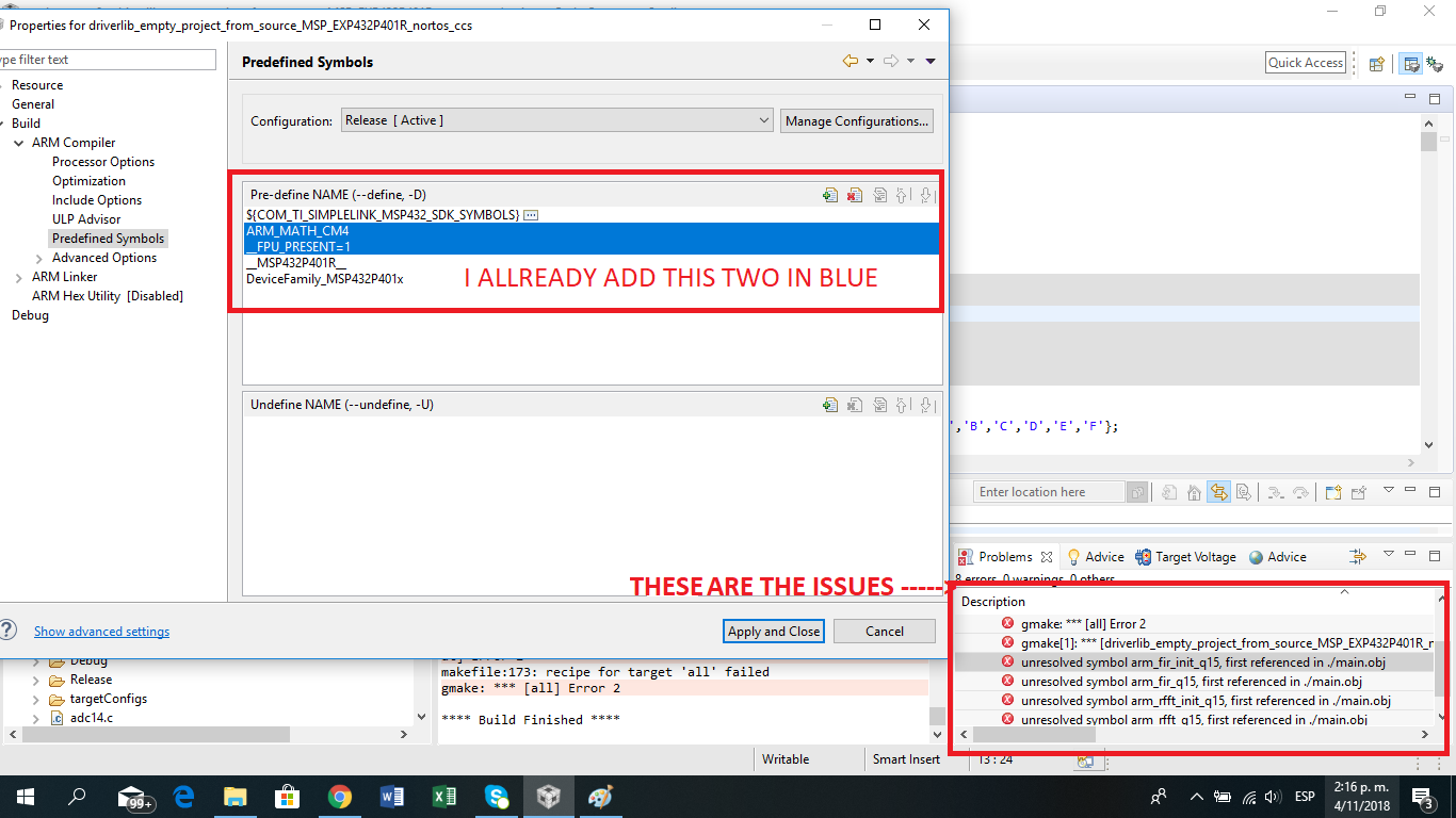

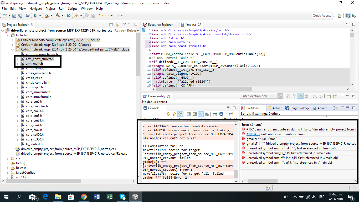

  • Okay, thanks for the answer!, but I understood from the image below that arm.math.h and arm_const_structs.h are already installed. Do I have to install it in a different way?
    thanks,
    David.

  • I have asked you to post Console log and you did not.
    It is pity. I need to help you making some assumption and guessing.
    Yes, arm.math.h and arm_const_structs.h are already installed and, what is more important, your compiler has right paths to access that headers.
    Headers are needed to compile the compilation units.
    Not seeing you Console log, I know that your main.c had been properly compiled.
    Your issue is not compilation but linking.
    You need to tell your linker which libraries are needed to build your out file and where to look for that libraries.

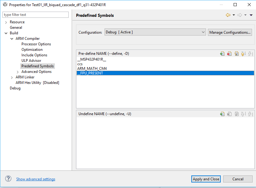

    You will find what you need, my guessing, on the picture below:
    Predefined symbols should be like this:
