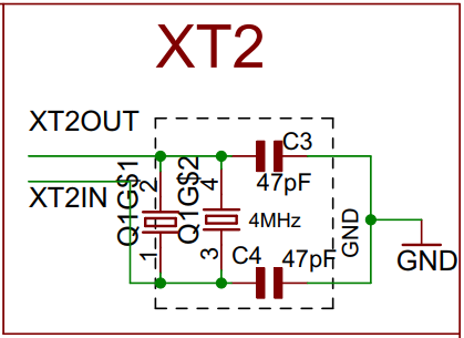

Could you clarify the value capacitor and Crystal oscillator frequency used in the schematic at page 15 of the application report SLAA514 ?
In my understanding they should be 4MHz and 47 pF, quite different of the value of Cl eff specified in the datasheet of MSP430 (SLAS645J page 27). The capacitor value that can accepts XT2 Input/Output (Cl eff) should be 15pF.

    You're correct that the frequency is 4MHZ and the capacitors are 47pF.

    I think you're referring to the XT1 section of the datasheet. The latest version is Revision K, and according to Footnote 1 under the table in Section 5.16 on page 29 of the MSP430F550x/F5510, the values of the load capacitances are specified by the crystal manufacturer. For XT2, the integrated effective load capacitance is only around 1pF.

  • I'm using a quartz with 12pF of Cl, but sometime doesn't start to oscillate at 4MHz, XT2IN remains at DC level of 300mV and XT2OUT is zero. The packege used is RGC for MSP430F5510 device
    The pad P5.4 and P5.5 are floating (refered to Crystal XT1 input), are there some external device issue to do to have the P5.2/XT2IN PAD in high impedence (SLAS645J, paragraph 6.11.6), in order to feed the XT2IN to Unified Clock System ?

    I'm sorry, but I don't understand what you're asking. Also, this question seems to be different than your original question. For new questions, we recommend that you start a new thread. I don't know if you're confusing XT1 and XT2 or asking how to set up the pins to use XT1 or XT2. On the firmware side, have you referenced the code examples for this device yet?
