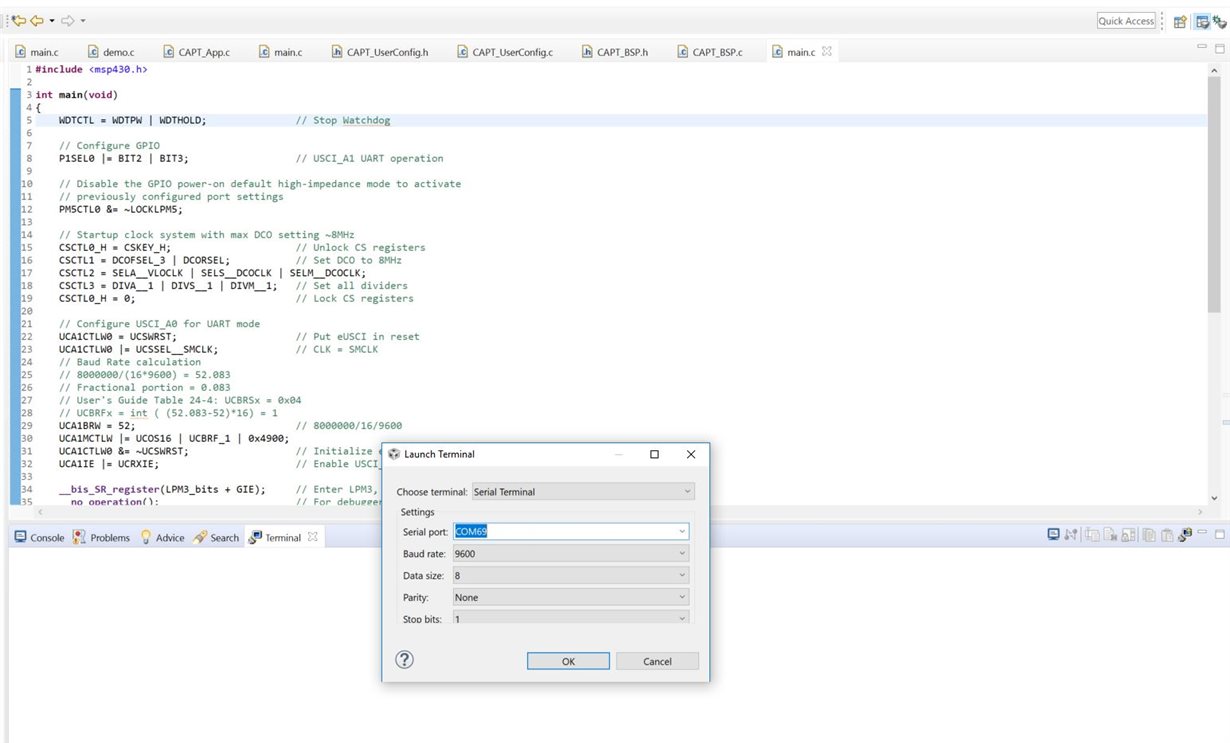

I am new to MSP430 and I am trying to learn how UART code works with the help of example code given by ti.
The example description tells me that the UART will recieve from the Serial port of PC and echo it back. I am using the Serial terminal present in the CCS and set the baud rate to 9600. But I am not able to recieve any Output.Am i missing something on EVM module ?or What is the right way to test the above Code?

  • Hi Divya,
    Really sorry for the late reply.
    If you want to use uart to send data to PC by on board ez-FET. Please use eUSCI_A1 which located in P1.2 and P1.3

  • Hi Ling,
    It would be a great help if you could tell me how to configure P1.2 and P1.3 as Tx and Rx for uart transmission.
    I didn't get a clear idea as to how to configure the ports from the example code.
    Divya

  • Hi Ling,
    Thank you for your prompt reply!
    I believe the code is for UART to recieve data from the Serial port of PC and echo it back.
    What change must i do if i have to transmit data using uart to PC?
    Divya H
  • Hi Divya,
    UCA1TXBUF = xxx;
