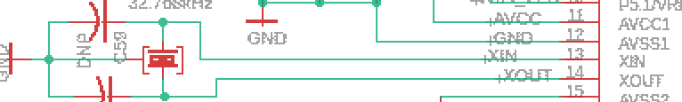

Hello, I'm trying to use MSP430f5359 for my project but the crystal oscillator is not working, i downloaded the code from resource explorer for msp430f5359 to test it but its still not working. Attach here is the circuit of crystal oscillator.
what am i doing wrong?
  • Hello Kary,
    Are you using a custom board? If so, have you provided the correct effective load capacitance for the 32.768kHz crystal you've selected for XT1? Please don't measure the crystal using an oscilloscope probe at the crystal. Instead, use one of the XT1 code examples to output the clock via the ACLK pin.
    You can find more information about using the 32kHz external crystal in the MSP430 32-kHz Crystal Oscillators app note. Also, I would recommend searching for answers here on the forum. Others have had the same issue, so there will be valuable advice on what to check and fix.
    James
  •  As there is no custom board for msp430f5359 , i designed on my own.  I have  provided the correct effective load capacitance for the 32.768kHz crystal. I used RTC_B in real time clock mode example from resource explorer to test it. Here is the link of code example :
    And attach here is the circuit i used:

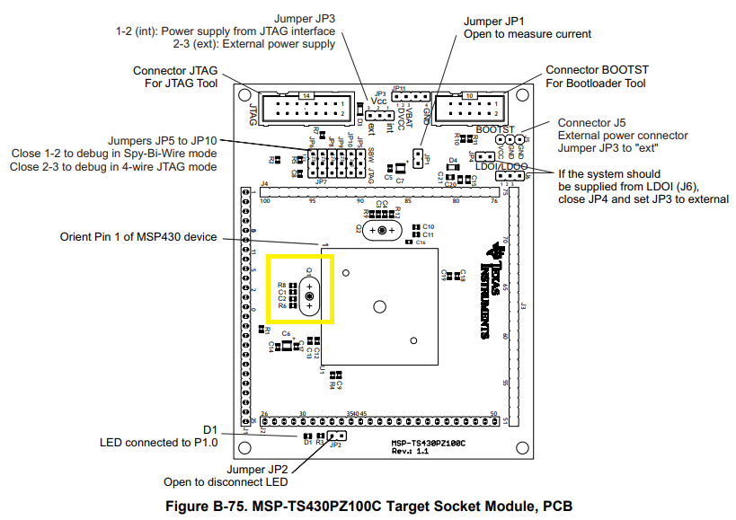

  • Hi Kary,
    In the code you shared, if there's an oscillator fault flag, it won't continue to the part of code that toggles the LED. Looking at the picture you shared, how you've soldered the crystal to the target board isn't how we recommend doing it. Since you're observing a frequency of ~27kHz, there's something affecting the crystal, and I'm suspecting it's related to the hardware, not software.
    Since you're using the MSP430F5359, I'm assuming the target board shown in your picture is the MSP-TS430PZ100C. Is there a specific reason why you couldn't solder the XT1 crystal at the Q1 location on the target board rather than soldering it underneath the headers?
    James
  • The board has no place to mount on Q1 postion. when i execute the previous  code, the led lights up but it's not blinking.
    I see. Unfortunately, this board is not our target board, so it will be challenging to test your crystal using this board, especially since the crystal is so far from the MCU, the large amounts of solder will affect the capacitance as well as the long jumper wire, etc. You may not be able to get past the oscillator fault flag using this hardware.
    James

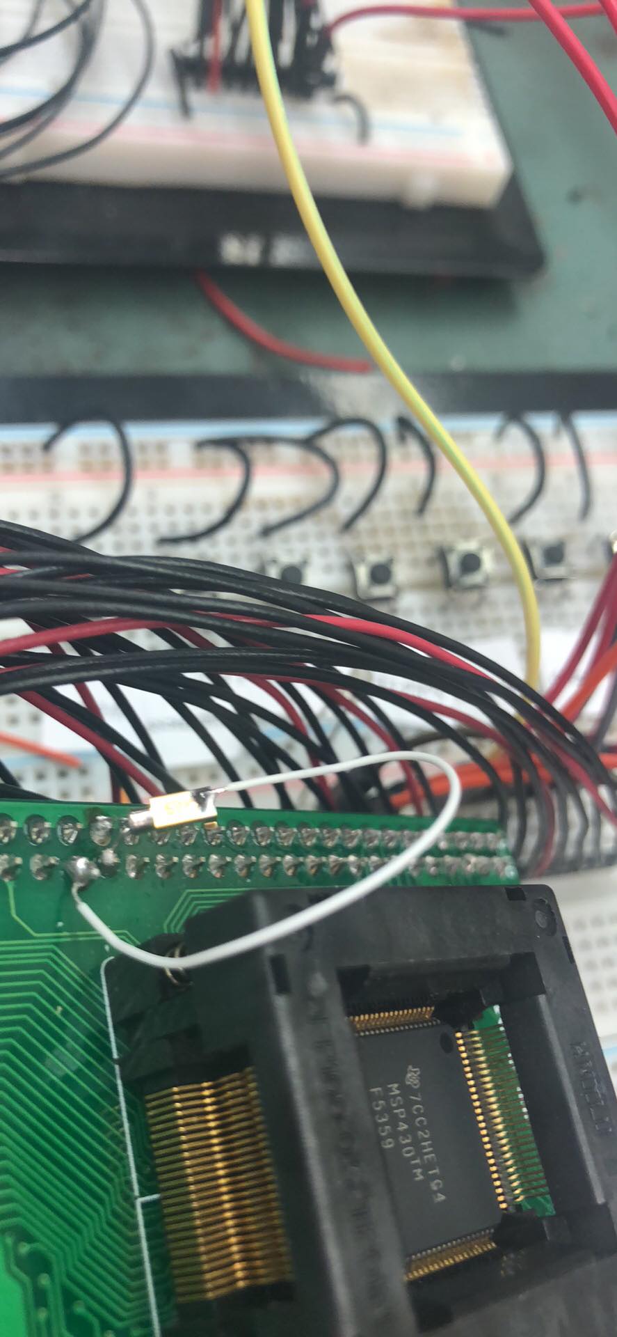

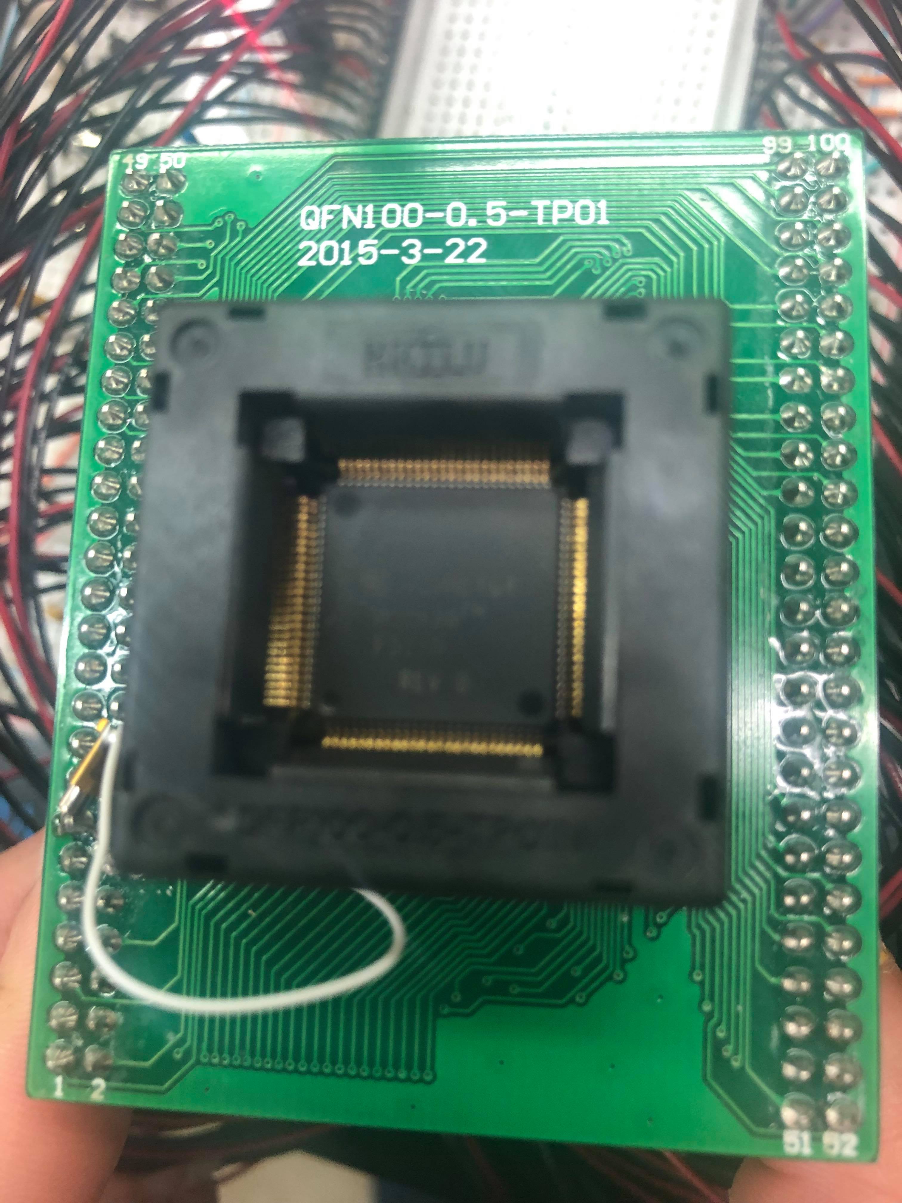

  • Just got TI board shipped and i couldn't pass oscillator fault not even in this hardware. Attach here is the hardware  and the code i tried from resource explorer.

  • Hi Kary,
    When you post code, it's much more readable when posted to the forum using the Syntax Highlighter tool (looks like "</>") found under the "Insert Code, Attach Files and more..." link shown after you click the "Reply" button.
    UCSCTL6 |= XCAP_3 | XT1BYPASS; // Internal load cap UCSCTL3 = 0;
    Why are you setting XT1BYPASS while trying to use an external crystal? This is probably why you're seeing an oscillator fault because it disables the XT1 module.
    That's great to see. However, I'm not sure why you haven't soldered the crystal to the through holes on the board at Q1. I'm not sure which example or examples you've copied, since you didn't specify that.
    Please try running the following code example to see if you can get past the oscillator fault.

  • yes, it did pass the oscillator fault and i placed crystal in Q1 too. i was about to use PWM for my device using xtal. can you suggest me any code for that?
    i didn't understand this line though:
    P5SEL |= BIT4+BIT5; // Select XT1
    there is nothing in 5.4 and 5.5 in msp430f5359.
    Great!
    Please search the forum or create a new post for this question.
    For the MSP430F665x devices, they don't have dedicated XT1 pins like the MSP430F5359. Thus, this line of code is necessary to configure the pins for the XT1 functionality on the F665x devices, but not the F5359 device (since it has dedicated XT1 pins).
    James
