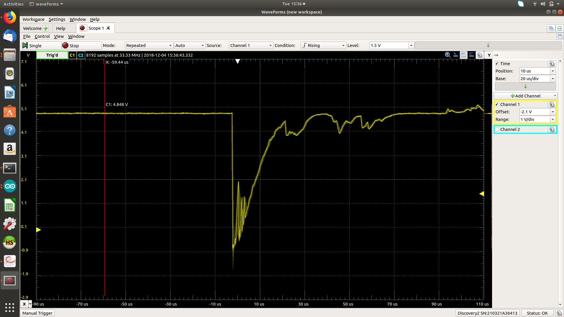

  • Hi everybody,
    Sorry for the delayed response from my side, I tested the interrupt terminal using a digilent USB scope and found the attached result when it is touched with a metal stick.
    Note that this only happens when we give an external touch. Is it due to hardware design?
    Are there any steps that I can do to minimize this so that no false interrupts are processed by the core.
  • Hey Shwetank,
    Thanks for the captures!   This does seem to be a problem from the hardware design/debounce circuitry.
    Have you tried also adding a few different sizes of capacitors?  It looks like these are extremely quick pulses, so I think they should be able to be smoothed out with a larger capacitor.
    If that doesn't work, can you provide a schematic for the circuit connected to the GPIO for the community to review?
    JD
  • hi,
    Yes the spikes are of approx. 20micro seconds. Earlier we added parallel bypass capacitors 0.1micro value but during the initialization, the system used to hand and no functionalities were working so once we removed them it used to come back to life. That was the reason for not connecting any caps in the circuit.
    The further wires goes to interrupt pins of the controller. However as described above, in the actual board we have depopulated these capacitors to avoid charging discharging that perhaps caused the system hangs.
    Also I have tried using RC circuits with 0.1micro cap and 1-10K resistor but the response were more or less similar.
  • Hey Shwetank,
    Thanks for the feedback. I think this issue can be fixed with standard debounce technicques.
    Hardware: It sounds like the 1uF capictors are to large with 10k resistions and are interfering with the communication. because these pulses are so small, we don't need a large RC time constant. There are some debounce calculators online to help suggest the right size cap for debouncing. I would probably try something in the 20-50pF range with a 10k resistor and see if that works.
    Software: Another solution is to implement a software debounce. You can search the E2E forums for many discussions on this but I found a good discussion: e2e.ti.com/.../1730534
    JD
