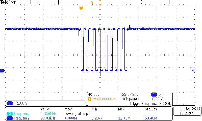

  • Hi Stefan,
    I have a change my code according to your suggestion and also configure UCB0BRW = 80.
    But, it gives me 98.03KHz on oscilloscope.
    I have a also attached screenshot of oscilloscope of SCL Line
    Still, I'm not getting any respond from the my I2C Device.
    Please do needful.
  • 9 clock pulses, then nothing, looks rather like a NACK. If you can get SDA on the second channel that would help.
    How are the A0/A1 pins set? Also, where is your actual I2C transaction code?

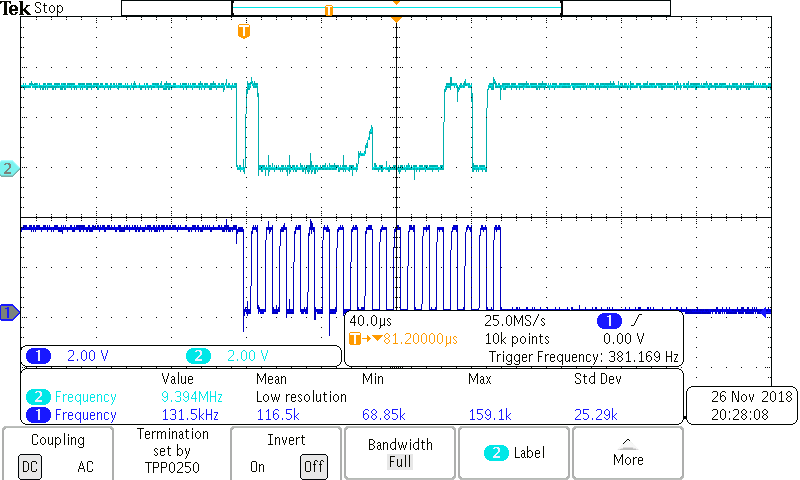

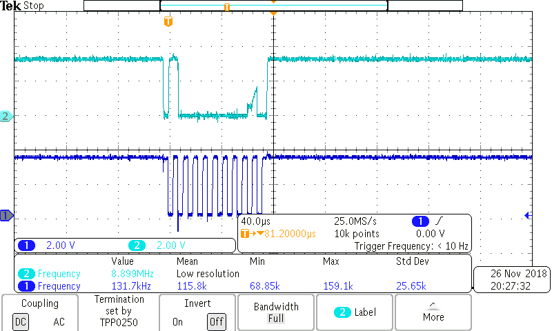

  • Please find attached files
    For 8 MHz frequency
    and
    Working with 1MHz
    Thanks in advance
  • Hi Kelvin,
    Interresting pictures:
    The timing looks already OK, so the clock divider settings are good.
    1Mhz send two characters and goes then into clock stretching where most properly the slave hold the clock low and will then stuck there. So for me that also looks wrong.
    8 Mhz just send one byte but everything looks OK till then.
    Can you share your code again. The one 8n the first mail just did contain the init part.
    Stefan

    1. On a case of NACK you should send STOP not START
    2. From you scope shots: with 8MHz it sends the STOP right after the address. So you do send the STOP to early. When putting the first and last byte into the TX Buffer it is still in the buffer when you set the stop bit when running with 8MHz. On 1MHz this may already be in the transmit state so it will put the STOP out on the bus after the data.
     Stefan
