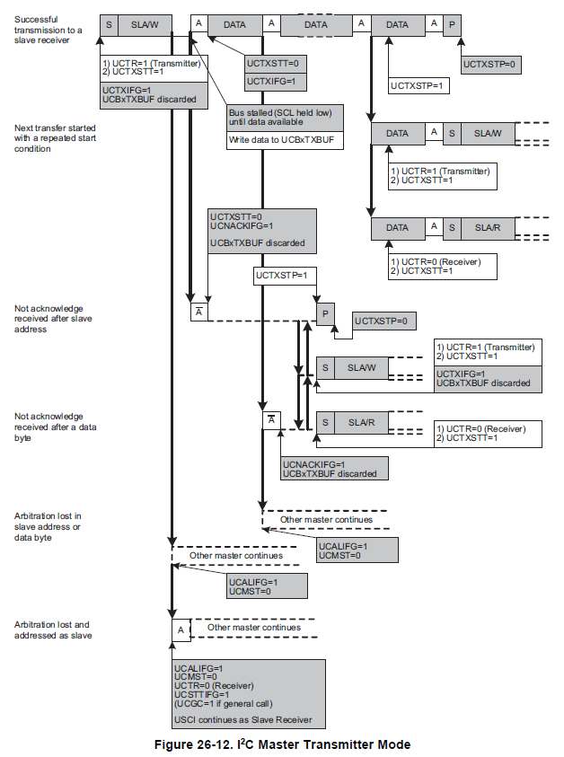

I think it is worth mentioning the active wait for UCBIT9IFG flag to be set in UCBxIFG register as a method for waiting the shift register to be flushed, for example by writing:
        // Wait until byte has not been successfully sent
        while(!I2C_getInterruptStatus(EUSCI_Bx_BASE, EUSCI_B_I2C_BIT9_POSITION_INTERRUPT))
At least, it works for me. It should be equivalent to the inline delay option, isn't it?
I do not need to use interrupts in my specific case, but I think the above flag should also make an ISR-managed solution possible.
  • On reading that thread, I suspect the real problem was that masterReceiveSingleByte issues a Start and Stop simultaneously. This case is not described in TRM (SLAU356H) Figure 26-12. Based on the OP's description, it is executed as a Stop followed by a Start, though intended as a Start followed by a Stop. Based on TRM section 26.3.4.2.1, I don't think any delay is needed.
    I suspect that Ms Thanigai's fix wasn't the delay, but the splitting of the Start and Stop (to assure the precedence). If masterReceiveSingleByte did that, maybe everything would act as expected.

    I actually need to do something similar to the routine shown in the example, and I am facing some troubles, so I am glad for the link: I will look carefully at it. Anyway, in spite of the example my initial doubt persists: Is it correct to wait on TXIFG before sending a restart, or not?
    I am asking this because according to user manual and the referenced post, TXIFG is set as soon as the shift register is loaded, so it makes sense to wait for the byte to be sent before issuing a restart condition (my MCLK is much faster than peripheral clock, also).

    before sending a restart. This is because I think it's more robust. From user manual we can notice that TXIFG is set before transmission happens:
    And this other flag rises at the end of transmission instead (weird it's not reported in the above diagram):
    Also consider that I have a 48 MHz MCLK and a 24 MHz SMCLK, while the example has both running at same speed (3 MHz).
