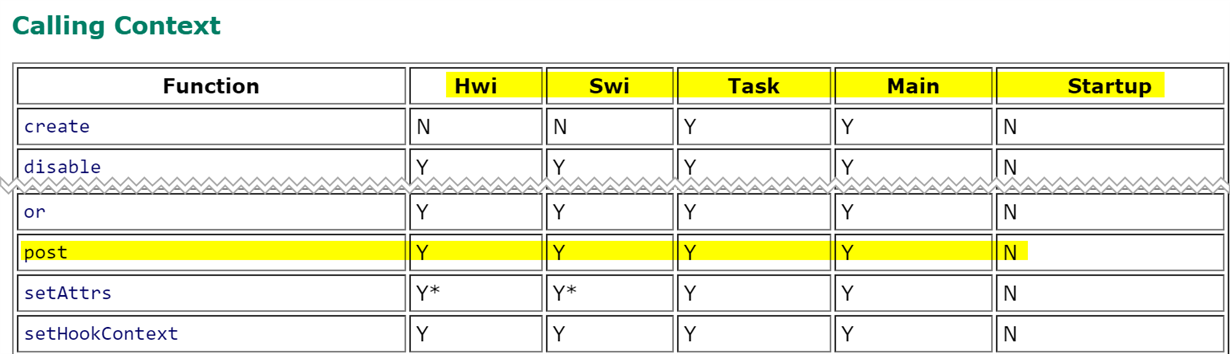

  • Did you check the System stack (ROV->Hwi->Module or BIOS->Scan for Errors)? Swi's run on the system stack.
    I'm not sure what you meant when you said "Clock_start() posts a swi.". Calling Clock_start or Swi_post from a Clock function is fine. Calling Clock_start or Swi_post from a Task is fine also.

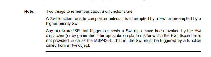

    Could you explain why calling Clock_start or Swi_post is fine? I've included a screenshot from the user's guide that seems to contradict. I'm just trying to understand everything going on.
    Page 68 of:  .
  • Hi Drue,
    Sorry, I was out of the office on vacation.
    The paragraph you attached is stating that if a ISR calls Swi_post, it must be a ISR managed by the SYS/BIOS dispatcher. It cannot be a zero-latency (non-managed) ISR.
    The best place to look is the Context calling tables in the SYS/BIOS API reference. For example, here is the Swi_post valid calling contexts
    Todd
