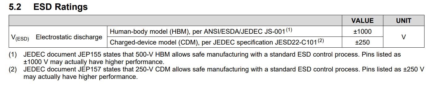

1. I thought that my customer test method violates Absolute Maximum Ratings and ESD Ratings in the data sheet. Is my way of thinking correct?

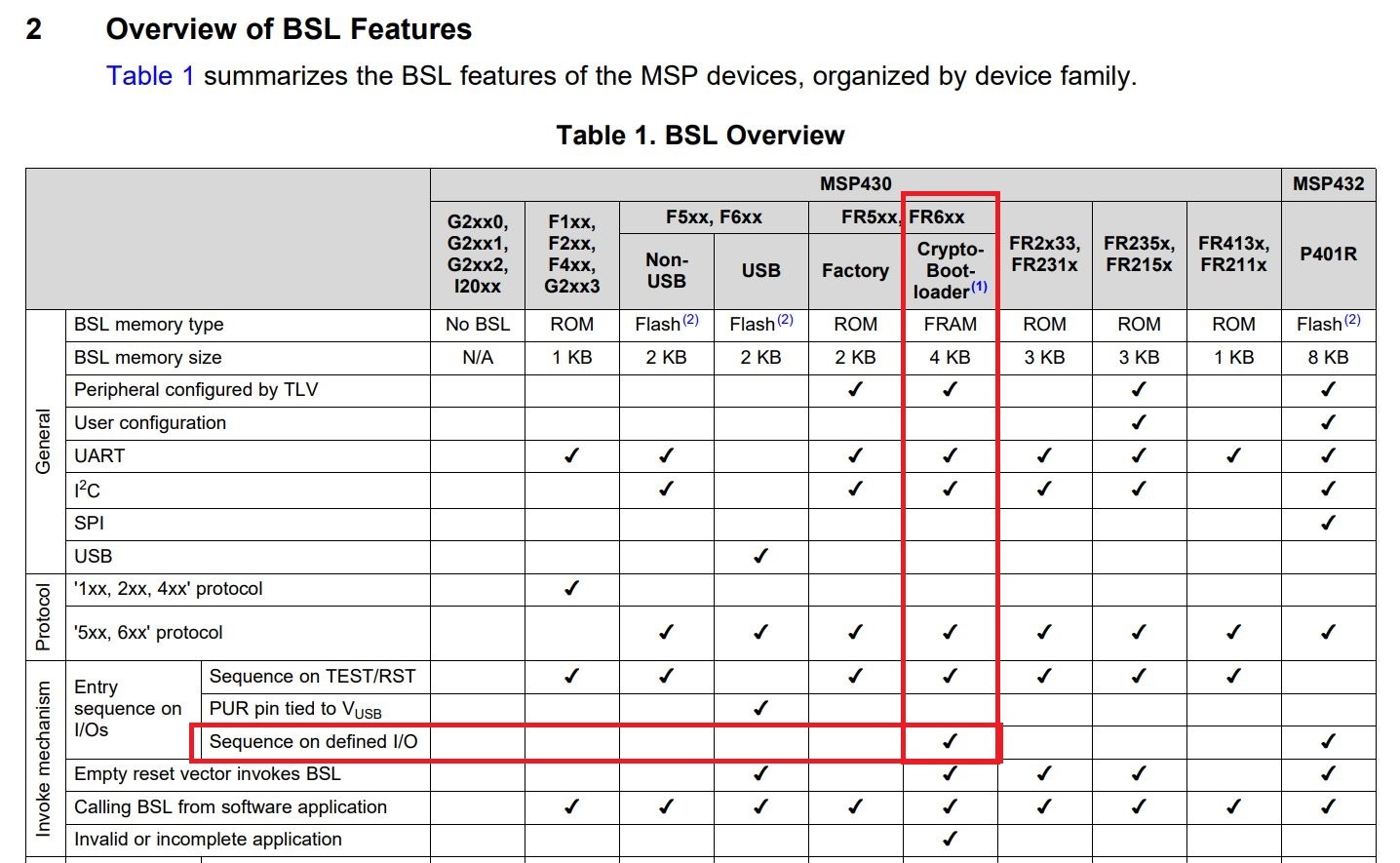

4. If it is BSL (UART), I think that firmware update is possible without using the TEST terminal, is it correct?

    Thanks for your detail post. The HBM ESD rating of MSP430 is +/-1000V. It seems the customer's ESD testing exceeds this rating. This will cause unexpected behavior of device and need system level ESD protection. I will discuss this issue with team and give a further feedback by the end of this week.

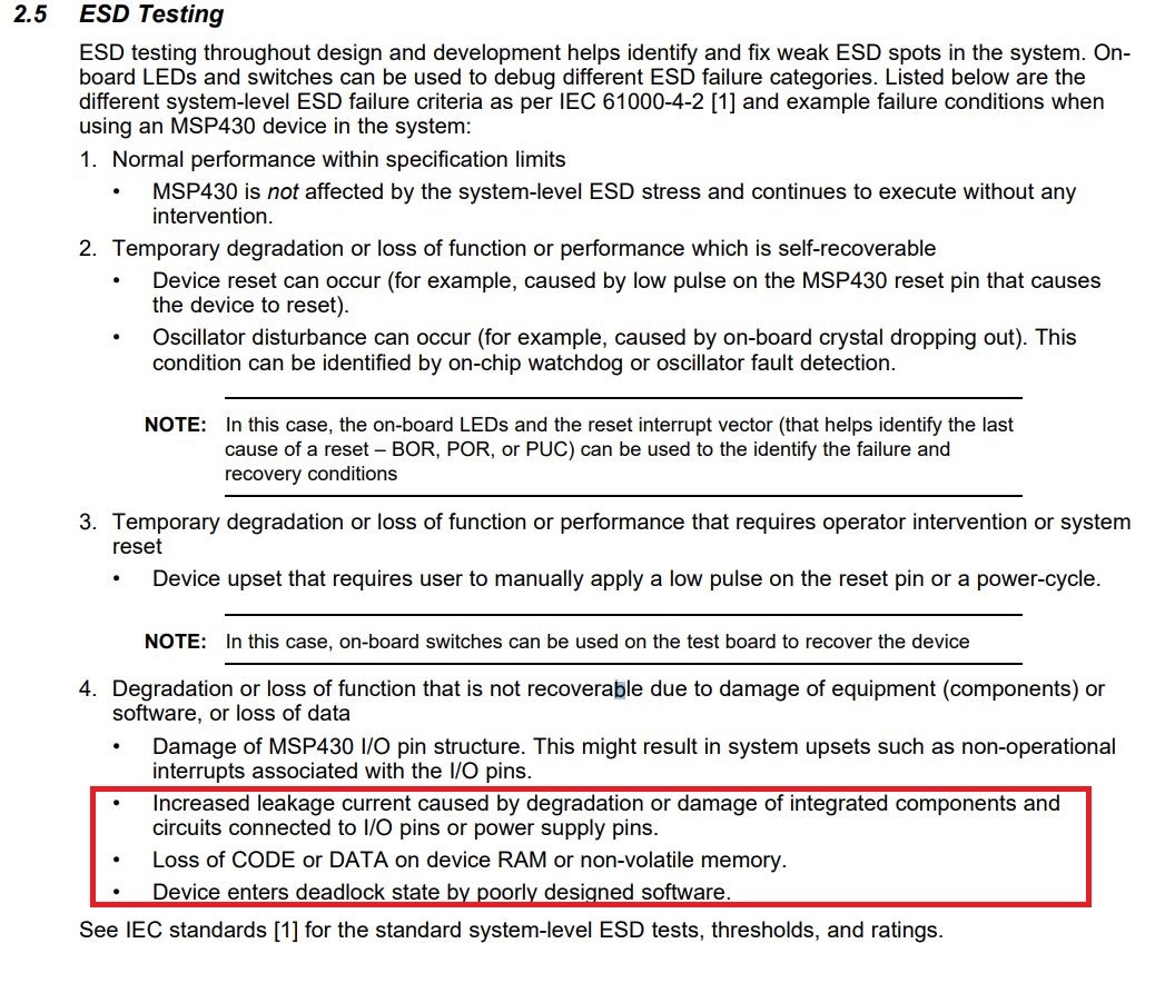

    Yes, you are right. The testing violates ESD Ratings in the data sheet. This may lead unexpected damage or malfunction of device, including increased leakage current, deadlock state of device. The deadlock state may lead device stay in Active Mode, which also increase power consumption.
    Please see the MSP430 System-Level ESD considerations for more details.
    (It builds the program counter to read the BSL address with application software.)
    Yes, it's correct. For FRAM based BSL,  the entry sequence can be implemented by user defined IO. See MSP430 FRAM Device Bootloader (BSL) User's Guide (Rev. P).

  • Hi Cruijff,
    As above reply, the ESD failure is complicated and unexpected, the consumption current increase is only one possible result and can be continuous or transient. It's also affected by software.
    I think we can't make conclusion that FRAM has weaker noise immunity from customer's testing with a small amount of sample. The performance with over-specs condition of device, is not what customer should consider and put in system design. Besides, the current consumption return to normal value doesn't mean device return to normal, ESD may cause potential damage.
    The Fash or FRAM memory is not the root cause which increases the current consumption when ESD failure.
