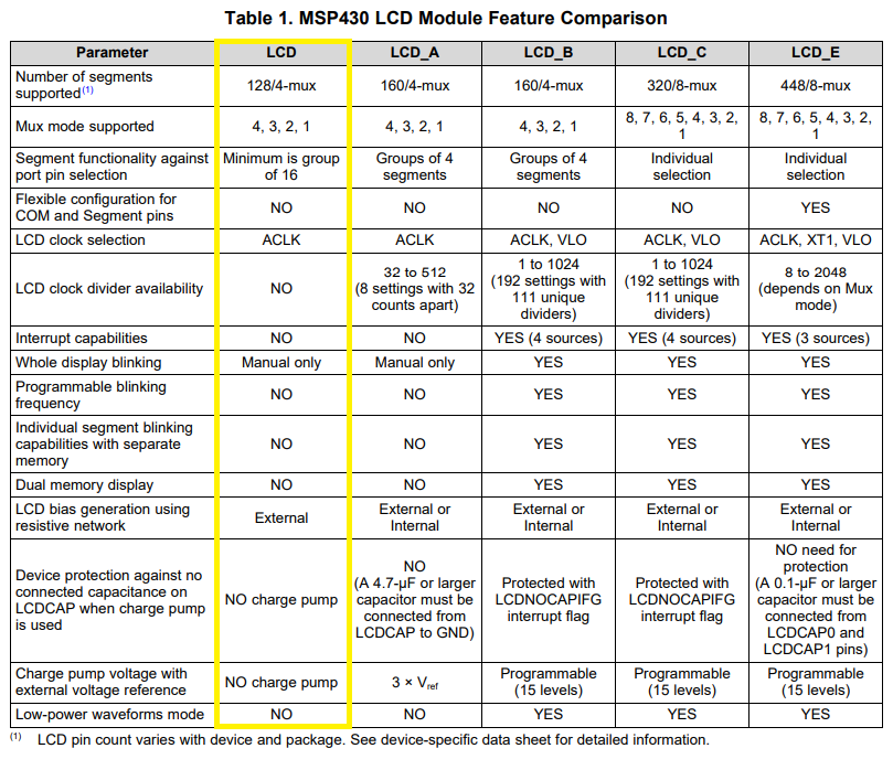

    Can you share more details about what you've tried? For an LCD to work properly, it will need to be supported by the MSP430's LCD module, the hardware connections between the MSP430 and the LCD will need to be correct, and the software configuring and controlling the LCD will also need to be correct. Please elaborate on each of these points in your design.
    For example, Table 1 in the Designing With MSP430™ MCUs and Segment LCDs app note compares different MSP430 LCD modules. The MSP430F427A includes the "LCD" module. Can you confirm that the LCD you're using is supported by the LCD's parameters?

  • 1. Hardware :
    > i have connected controller and capacitor of reference
    > i have connected one crystal 32kHz
    > i have connected registers between R33,R23,R13,R03
    > i have connected capacitor for stability between R23 and ground , R13 and ground .
    > i have connected my lcd (which i am using in from last 15 years in my product with msp436 controller)
    > i have connected one jtag fro for programming .
    that's it .
    now in software i am using this code please also check it .

    Are these connections on a PCB? This is important because how the crystal gets connected can affect the load capacitance. A schematic would be helpful too.
    I think you mean "resistors" here instead of "registers". The resistor value R is typically 680kOhm but can range from 100kOhm to 1MOhm depending on LCD requirements as described in Section 25.2.4 in the user's guide. Are they all the same resistance and within this range? Note that the bottom resistor Rx can be a different value to adjust the contrast as illustrated by Figure 25-1 in the user's guide. However, to ensure maximum contrast for debugging purposes, replace the resistor Rx between R03 and GND with a short.

    In your code, BTFRFQ1 produces an LCD frequency of ACLK/128 which creates fLCD = 256Hz. According to the equation in Section 13.2.4 in the user's guide, this would support an LCD frame frequency, fFRAME, equal to 32Hz. Does that match your LCD's frequency specs?
    Also, you're using LCDP2. This means that only segments S0 to S19 are functional according to page 727 in the user's guide. Does this match the number of segments on your LCD? In the for() loop, you're increasing i from 0 to 24 which is more than the number of segments by LCDP2.

    Last but probably the most important feedback, LCDMEM starts at address 0x0091, which corresponds to LCDMEM[0]. At LCDMEM[12], this corresponds to address 0x009D or n = 24. Thus, you're trying to control segments 24 and 25 (according to Figure 25-2 in the user's guide), but since you're using LCDP2, these segments aren't enabled. This is most likely why you can't control the LCD.
