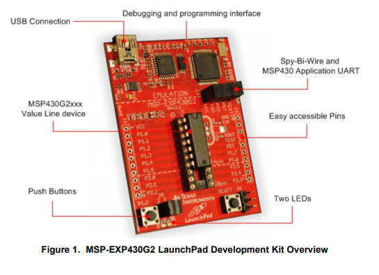

I'm a rookie in this realm of micro-controllers, but have some self taught programming experience and a Systems Engineering background, however; I'm stumped with my dilemma.
I've searched the Ti/E2E forums, found a lot of related topics but nothing that seems to resolve my problem. I'm getting a message of No USB FET was found.  I found a few related items and a couple that lead me to believe that maybe I don't have everything I need to move forward.  In order to debug, do I need another peripheral device to connect between my computer and the Launchpad?  Both of the links below reference debuggers such as the ez-FET.  Do I need to acquire one of these for the MSP-EXP430G2 or are they just a nice to have?
  • Hey Matthew,
    No, you don't need a seperate programmer for any of the launchpads.  These boards have the programmer/debugger built on.  It's the top half of the board labeled Emulation, seen here:
    I have a few more questions on how you're seeing this message:
    1. Which exact Launchpad do you have?  The MSP-EXP430G2 or the MSP-EXP430G2ET?
    2. Is the board plugged into the PC and have a green Power LED that's on?
    3. Are you using Code Composer to try and program the Launchpad, or something else?
    JD

  • Do you have the jumpers (J3 on the PCB) properly connected?

  • That's a good point. I wasn't before, but then I noticed the startup guide has a configuration for HW UART on the J3. I have since arranged the jumpers in that configuration, but that did not seem to help.

  • The fact that the USB is fading in and out suggests a flaky connection upstream. You might want to try a different USB cable. A bit of a long shot, but a quick experiment.
    To isolate it, you can try removing all the J3 jumpers. You (obviously) won't be able to talk to the MSP, but if your USB flakiness stops that points to something on the MCU side of the "dotted line".
    Do you have anything connected to the pins (J1/J2)?

    Take Bruce's suggestion of removing all the jumpers to isolate the programmer side of the board and try a different USB cable and a different USB port on your computer. If you're using a USB hub or extender, also try connecting straight to the PC.

  • I took all of the Jumpers off and got the message:
    "Unable to connect to MSP430G2553.
    Please unplug and re-plug the USB connection and try again.
    TI MSP430 USB1/MSP430
    Error connecting to the target: Could not find device (or device not supported)"
    So, then I started adding the Jumpers until it connected. After adding the jumpers to VCC, TEST, and RST it appears the problem was resolved. Now when I run the debugger I get this:
    Flash/FRAM usage is 630 bytes. RAM usage is 88 bytes.
    I've since been able to make some changes and flash the device several times.
