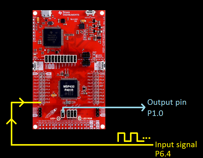

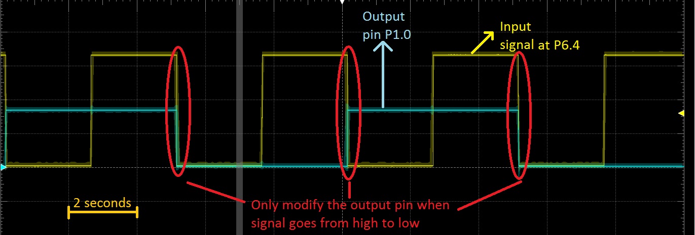

I have been trying to detect when a signal goes from low to high (0 to 3.3 V) using the MSP432 button example, in the code below I am using P6.4 to detect this, the problem is that for some reason the program only triggers the interrupt (PORT6_IRQHandler) when the input signal goes from high to low, even thought I configured the resistor as pull down or pull up (neither of them allow me to detect when the signal goes from low to high). Does someone know's why?
Note: The ISR PORT6_IRQHandler turns on and off P1.0, the problem can be better observed in the image below where the input signal and the output pin where monitored.

  • I think you're looking for something like
    GPIO_interruptEdgeSelect(GPIO_PORT_P6, GPIO_PIN4, GPIO_LOW_TO_HIGH_TRANSITION);
