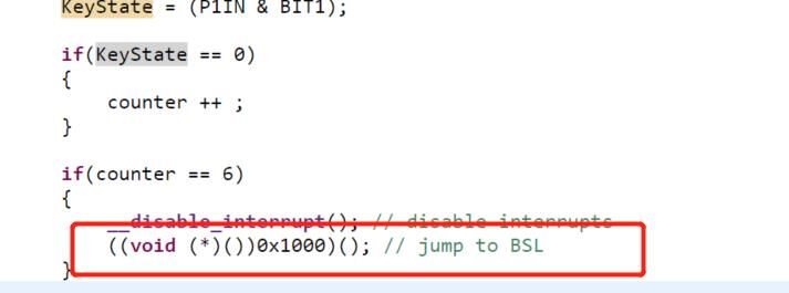

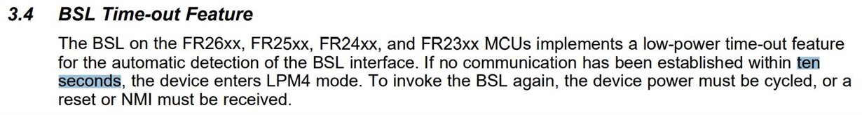

      l use ti MSP430FR2311 in my robot application    I press the button and the program enters BSL. If I upgrade the program immediately, it will be successful.But if after entering BSL for a while, about ten seconds,
it  can't soft upgrade  again, what`s the reason of the problem ,how can l solve this problem ?
