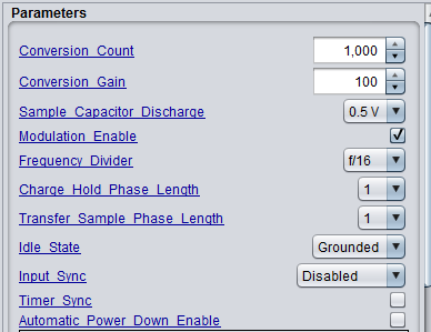

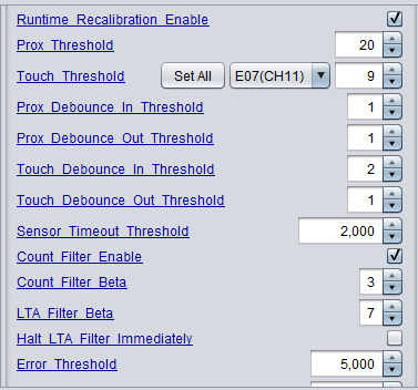

    Here are my parameters in case I've missed something.
  • Hello Nathan,
    Thanks for the detail explanation on your issues.
    Based on your configuration, I notice the Charge Hold Phase Length and Transfer Sample Phase Length are set to 10. Any reason why you want to set these two parameters to 10?
    For a typical design we recommend to keep these two parameters to default 1.
    As the picture shows below, each measurement, or "conversion," consists of a series of charge transfers. For a self capacitance sensor, a charge transfer is composed of a charge phase and a transfer phase. When you set the Charge and Transfer Phase Length to 10 that means it takes 10 conversion clock (in your case, f/16) cycles to complete one charge transfer step. This means the scan time for all your sensors will be really long. For typical design and also for the BSWP board you are using, we recommend to use 1 for both charge phase and transfer phase length.
    Please try this and let me know if you still have these issues.
    Yiding

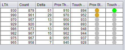

  • It seems to be running better with shorter phase lengths, but the only situation I've been able to get a "Good" evaluation in the SNR tool is with the phase lengths set at 10. If I keep the phase lengths low, can I increase the Conversion Count to compensate or am I missing the point?
  • Hello Nathan,
    What is the delta you are getting with 1000 conversion count and (3/8'') glass?
    Yiding
  • Hello Nathan,
    I think "CHARACTERIZATION ADVISED" is ok for your initial evaluation on the BSWP board and with your glasses setup. Because the BSWP board has a 1.5mm overlay and also you don't have the good bounding between glasses and the BSWP board which means in your actual design the overlay thickness will be thinner without the 1.5mm polycarbonate and with better bounding and also you can design the sensor to be larger. All of these will increase your sensitivity from the hardware design perspective.
    Yiding
