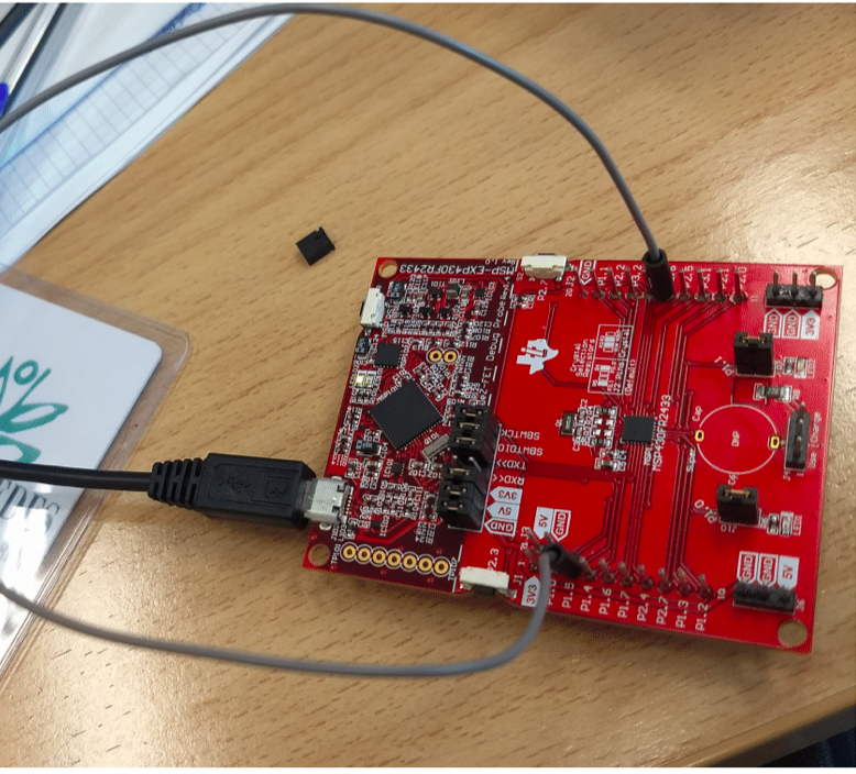

  • I understand(?) that you've jumpered UCA1TXD to UCA0RXD, and UCA0TXD goes out through the USB.
    Did you remove the RXD jumper from the J3 ("bridge") header? If you didn't, both UCA1TXD and the ezFET will be driving the UCA0RXD (P1.5) line.
    I suggest you start by jumpering UCA1TXD directly to the TXD pin on J3 (USB side), and see if you get an "ok" using PuTTY. This will assure that you've got the clocks and such right.
  • Hello Bruce,
    Thank you for your answer, I admit, I don't understand all your recommendations, initialization for me is complicated. However, I will try to lighten the code and do what you advise me to do, thank you very much.
  • I was suggesting just moving some wires. First thing: Remove the RXD jumper (small black plastic thing) from J3 on the Launchpad.
    What wires do you have connected now?
  • Here is how the card is wired
  • When I wire my Launchpad that way, and put your code on it (I had to fiddle the includes a little), PuTTY (115200-8-N-1) prints "ok" repeatedly.
    One thing to watch out for: When the debugger is active, UART data comes out in a bursty fashion (something like 64 bytes/3 seconds due to the USB), so you need to be somewhat patient. When I disconnected the debugger I got "ok" maybe four per second.
    I'm not sure what you and I are doing differently.
    [Edit: I was mistaken referring to J3 when J101 is the "bridge" header. I think J3 is that two-pin thing nearby with 5V/GND. You seem to have figured it out, but I'm mentioning it for future archaeologists.]
